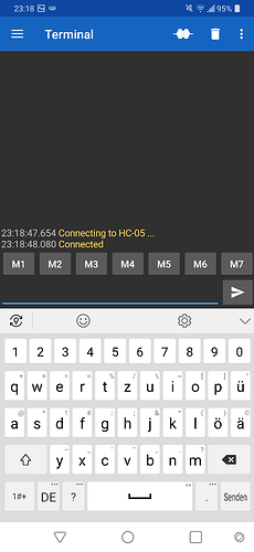

I am trying to send a simple string from my arduino nano to my mobile phone (i have the "serial bluetooth" app on my phone).
  • The code upload correctly to the arduino
  • the bluetooth app recognises the hc-05 and makes a connection
  • The text "serial started" appears in my serial monitor on my pc
However, the text ".hallo bluetooth device" does not appear on my phone. I have been reading tutorials for like 3 hours straight, yet i have no clue what i am doing wrong. I have checked and double-checked the connections on my breadboard. What am i missing here? Any help greatly appreciated!

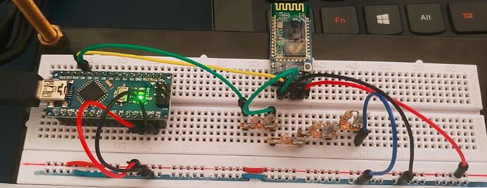

Hi!
I just completely re-wired my breadboard (see attached picture), uploaded the sketch again und changed the baudrate of my software-serial to 9600. This did not help, still no sending to the mobile possible.
I am kind of lost now. Do you have any idea what else I could try?

Not only have you got the pins the wrong way round, but you are also apparently using the wrong pair of pins.
has nothing to do with Arduino other than that it is providing power.
but has nothing to do with Bluetooth. They are just words that you have told Arduino to send to serial monitor.
There is nothing wrong with using a fritzing diagram, but a clearer picture of it would be helpful.
As @Nick_Pyner says, it looks like you have the RX and TX connections still incorrect. The parallax makes it hard to see the actual pins connected.
The software serial constructor is from the point of view of the Arduino.
SoftwareSerial mySerial(11, 10); //RX, TX
Pin D11 is the Arduino RX and should be connected to the module TX. Pin D10 is the Arduino TX and should be connect to the module RX. There is a cross connection of RX/TX between the Arduino and the module. TX>RX and RX>TX

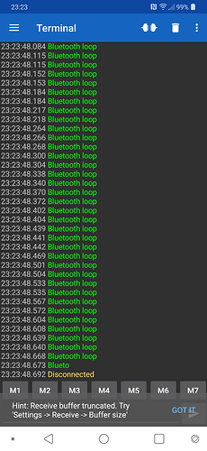

Apart from the connection notice, i still get nothing at all on my bluetooth terminal program on my phone. Even with a wrong baudrate, i should get something?
I would think so, but it may depend on the terminal app.
I'm not familiar with the Nano and I see that I was wrong about you using the incorrect pins, but they were still the wrong way round. I will blame your crappy picture for that. You don't say, but I hope you aren't using an iPhone.
