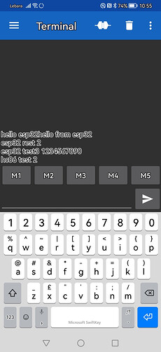

and smartphone displayed
NOTE: I was using a ESP32-S3-DevKitC-1 - its 5V pin could not power the HC-06 which I powered from a UNO 5V supply

using the ESP32-S3-DevKitC-1 the example creates the 'UART service'
connecting using an Android phone
serial monitor displays

smartphone
the above sends text messages from serial monitor
you should be able to read data, filter it and transmit it
you can transit data as text or in binary with the app decoding it etc etc

Thanks for your comment. The code I have takes 1000 samples per second to have an accurate ECG signal, do you know if the Nano's BLE is capable of these high speeds?
I tried the BLE with uart code and this is what it sends, I have attached a photo of the terminal and the Arduino code. How can I get it to send numbers?

the File>Examples>EsP32 BLE Arduino>BLE_uart transmits characters in loop() - hence the screen full of characters
have a look at the code from post 10 it is similar but transmits numbers in loop()
I have had applications transmitting 1000bytess/second over BLE using a Microchip BM71 using transparent UART - I assume an ESP32 should be capable of similar speeds - to reduce data I used binary rather then text
Thanks again for your comment. Which part of the code is changed to send numbers and not characters, is it in this part of the code, and if not which parts should be removed?
