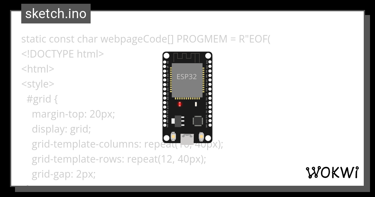

This could be a good example to start from (it's not mine, I found it by googling)
The page is created dynamically with Javascript (the hard job is done by the browser and therefore saving MCU resources).
There are 2 AJAX calls: the first associated with a checkbox to turn on and off a LED, while the second associated with the click on one of the dynamically created cells
If you declare the array not as constant, you can do it, but anyway it's not a good practice because you have to handle all such long string in SRAM before returning the HTML page to the client.
