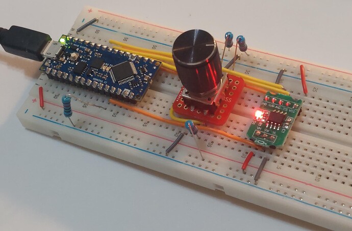

And just in case anyone needs it, here are some pictures of the actual circuit:

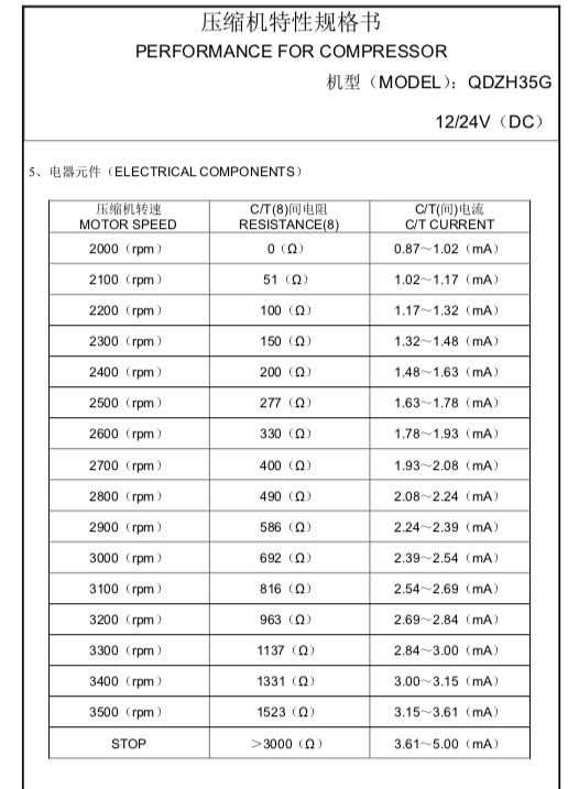

The purpose is to control the speed of a compressor I have, model GDZH35G. It starts up at about 2k RPM, but can get up to 3.5k if you control the resistance through two specific terminals on the control unit.
I don't plan on always having it at 3.5k RPM, otherwise I would just attach a 1.5k ohm resistor there. But I would like to be able to control it via Arduino (Im testing this out on a Nano Every, but I have a Mega if the need arises), hence the digital resistor.
The problem is that it will shut off if the resistance gets too high. Which is why It would be nice to be able to monitor it (though I'm working on being able to determine the the RPM via some other means - eg: the current being consumed).

Yeah, its a hell of a mess. But basically its built off of this simple tutorial: How to Make an Arduino Ohm Meter, Which works fantastically, but then when I switch out the "unknown resistor" with the output of the X9C103P, that's when I start getting the crazy high readings.
The relevant parts of the "diagram" I posted above are the R1 resistor (the "known" resistance) which goes from ground to analog pin 7, and the X9C103 (the "unknown" resistance) which also connects to analog 7 (via the orange wire coming out the bottom of the X9C breakout board)
Does that help at all?..

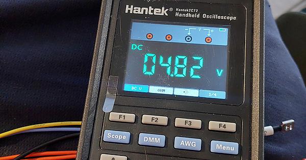

Ill see if attaching my multimeter to it will give a reading, I thought that since its on an active circuit, it won't read a resistance, but maybe if I disconnect it and just hook up the multimeter between the wiper and the low terminal it will.

But anyways, guess what guys... I fixed it.
While it was running, I removed the ground pin from VL on the digipot so I could attach the multimeter, and the output in the serial console of Arduino started to show exactly what I would expect. lol. I guess I should be using this more as a rheostat than a potentiometer (If I'm understanding the two accurately)

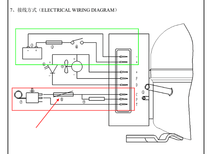

It's important to know that the connection that I need to control the resistance/amperage isn't at all the connection that is used to power the compressor motor. Its actually on the thermostat that's used to control the temperature if it's getting too hot or running too long. But you can override it with a resistor (or rheostat).
In the image below, the thermostat line is in red (with the variable resistor at the red arrow), and the 12v power is in the top (green) outline.
Obviously it's possible that the leads just connect inside the control unit and the thermostat just controls it directly by changing the resistance, but I would think that if that was the case, a lower resistance would result in a faster RPM, but it's the other way around. I think they kinda just use the resistance as an indicator to where the RPM's should be set to (almost like a user input), but I could absolutely be wrong on that.
P.S., You can see me testing the control using a potentiometer here: Compressor test - Album on Imgur

Read up through the posts, the pot (or rheostat, I guess) hooks up to the thermostat leads, not to the 12v power leads directly. You can control the speed of the pump/compressor by controlling the amps between the C (control) and T (thermostat) terminals.
I measured the amps on the C/T terminals while it was running, and it only got up to 5.11mA, which is pretty manageable. But as someone pointed out above, the digipots im using can't really take that load, so I'll likely use a different type. I ordered a couple different types from Digikey to try out. One of which is the AD5122A, which goes up to just 10k ohms, 8% tolerance and 6 mA wiper current.
