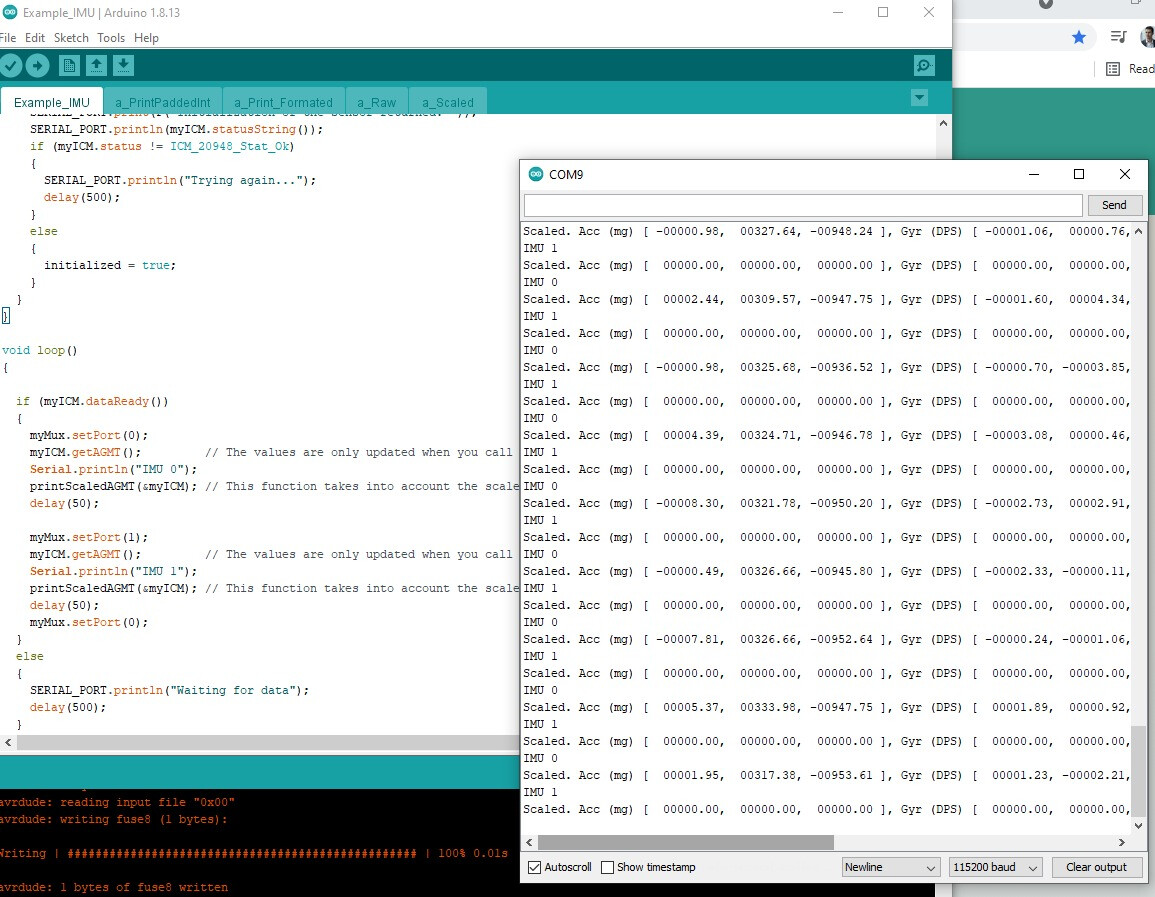

Im using the arduno nano Every with a qwiic shield:
Connect to SparkFun Qwiic Mux Breakout:
With two SparkFun 9DoF IMUs - ICM-20948:
And my problem is that using the following code, I only get a few lines of data printed showing the measurement of the two IMUS before it stops (or 'freeze') for a reason I can't figure out:
My code:

if (myICM.dataReady())
myMux.setPort(0);
myICM.getAGMT(); // The values are only updated when you call 'getAGMT'
Serial.println("IMU 0");
printScaledAGMT(&myICM); // This function takes into account the scale settings from when the measurement was made to calculate the values with units
delay(50);
myMux.setPort(1);
Serial.println("IMU 1");
delay(50);
myMux.setPort(0);
Serial.println("Waiting for data");

I noticed that when using just 1 IMU by commenting the lines:
myMux.setPort(1);
delay(50);
myMux.setPort(0);
I get good constant readings for that 1 IMU.
What am I doing wrong?
