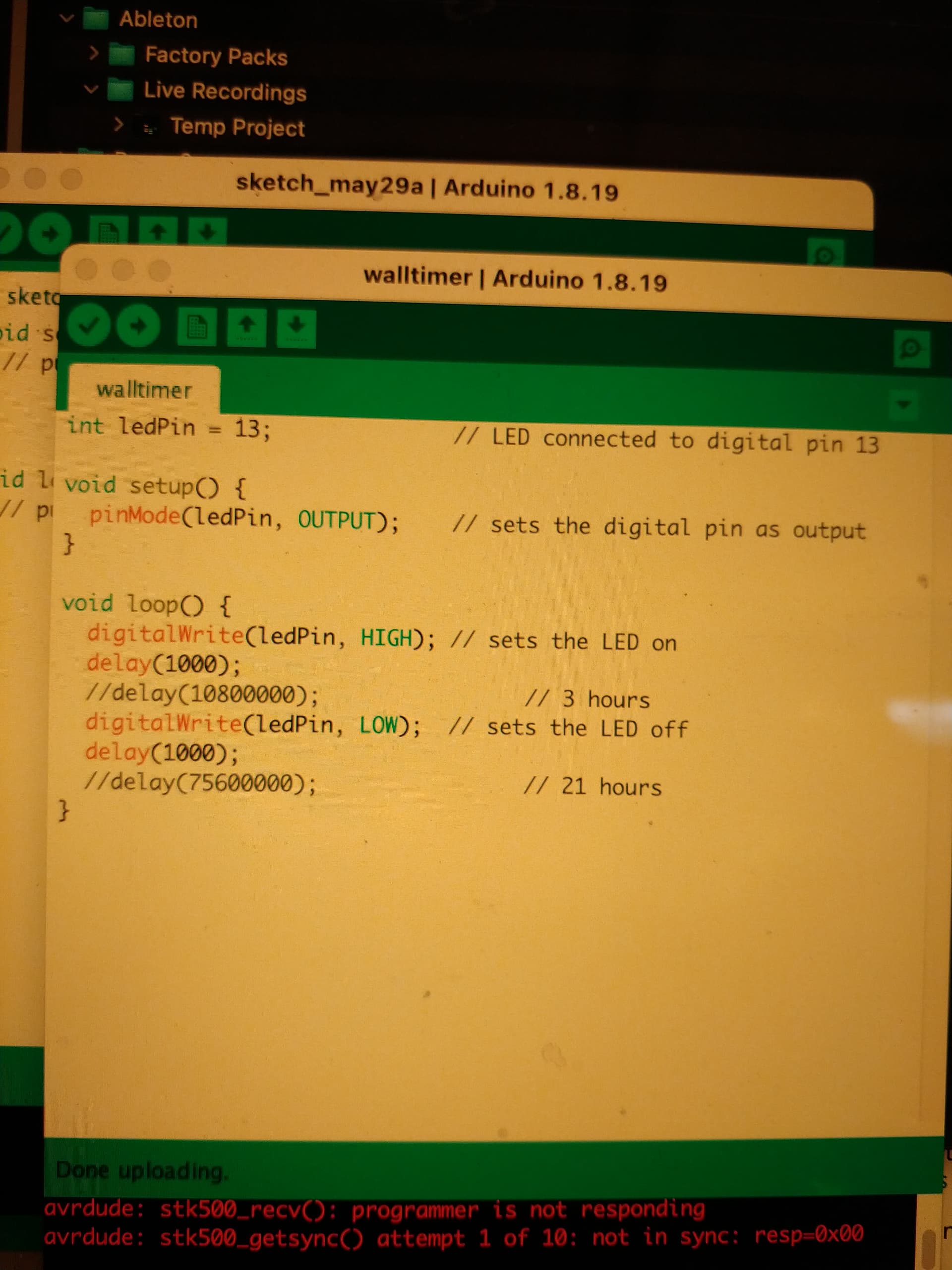

I'm thinking maybe I'm using the wrong 'programmer'? See the error code in the screenshot...

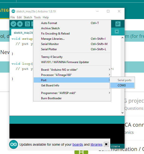

You need to choose the right Port too --

Thanks for the tip on the port. I think this is correct but I'll try again.

Your screenshot in post #1 suggests the upload was not successful.
Is that still the case?
For troubleshooting it is very important to know where things go wrong.

If you hit the upload button in the IDE, these steps will be performed automatically. The text in orange tells you what thing were successful and what things caused trouble. We need to know where things go wrong...
I.e. upload not successful:
Try another cable...
Or better: try another board. If that works, you know the cable and port settings are ok so the problem must be in your board.
So let us know where the process is stuck!
From your screen output I conclude that the program was not successfully uoloaded...
...your settings may be wrong, your cable may be wrong and or your board is faulty.
Best way to test your cable and settings is to upload to another board.

It should show up in DeviceManager as a COM port.
That would also be a good sign... at least it would rule out that the cable is charge only ...
