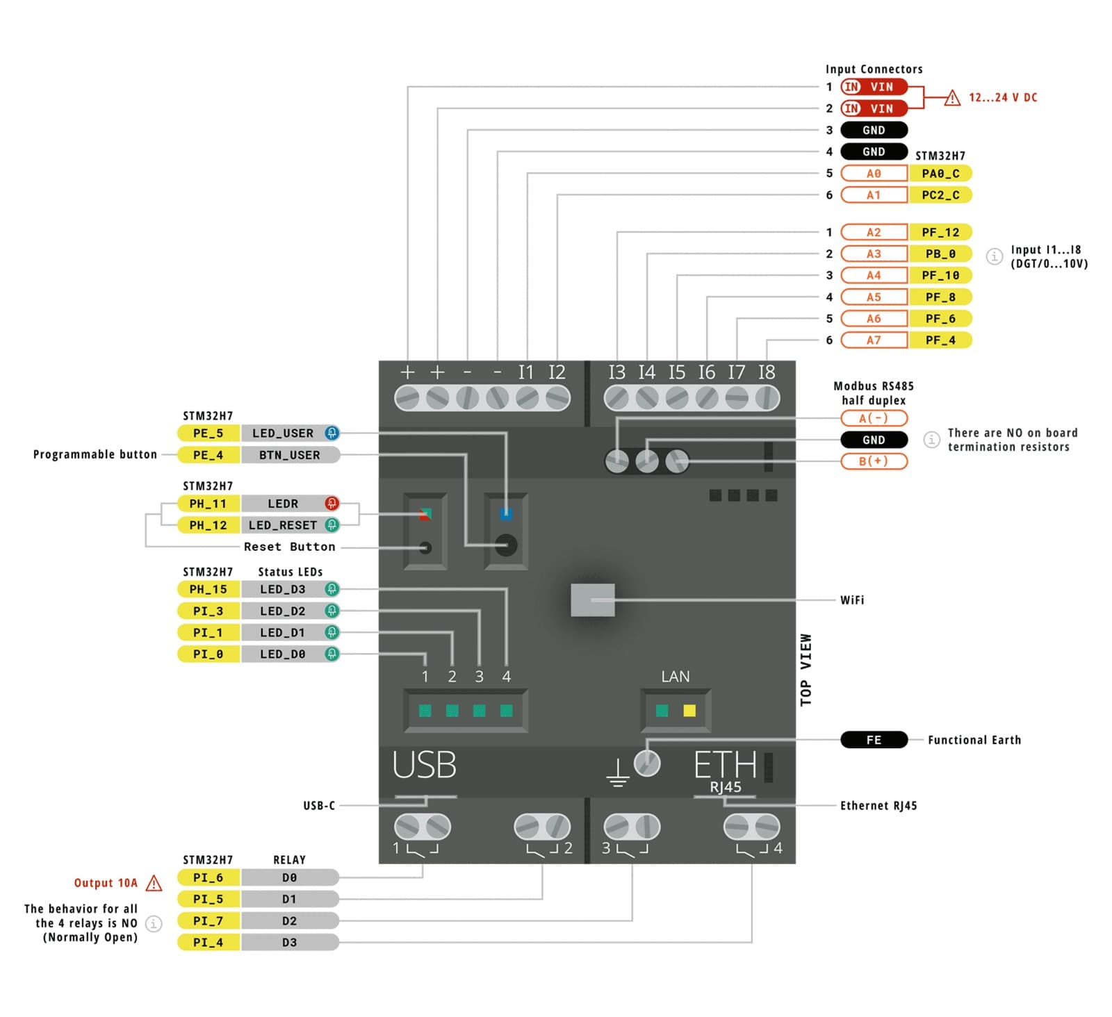

  1. To segregate the electrical circuits I will place a relay from Finder in between the LED and Arduino opta. The Relay will be powered up from an external source. I need just a digital input signal that shall tell me when the LED is HIGH. I have found some discrepancies in various datasheets from Arduino OPTA and I see in the PDF datasheet that the DI signal is at least 6.6 Volts as specified here in the VHL, and the DI voltage is 0 - 24 V DC capable.
Then if I look at the pinout it seems the DI is 0 - 10V which contradicts the datasheet. Both pieces of information are from the official website:
Anybody who tried a similar situation and can provide some feedback? I have 3 power supplies available: 5V, 12V and 24V. If 5V is not enough to trigger a high voltage and 12V is too much then I am in trouble.

For anybody looking at this, I am just posting my resolution:
  1. The 24V are for digital input while 0-10V is used for analog inputs
  2. If you won't have a COM like you are used from normal PLC / Embedded systems just put the "-" from the system you need to monitor to Opta "-". So opta "-" is a COM.
