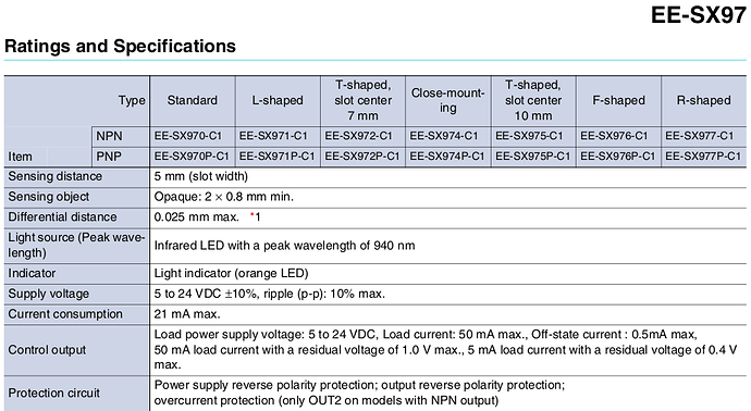

It took me a while to check if the Omron EE-SX972 will work at 5V. The page for the EE-series has a document, and in that document, look for the "EE-SX97" series. It will work at 5V.
