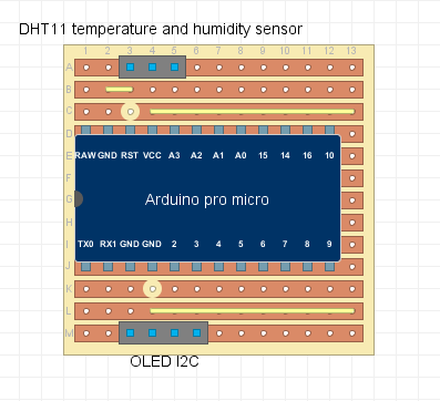

If you are using cables, I'd recommend that you buy a board of some sort if you are looking for something a bit more permanent than a breadboard. A Veroboard is a good choice, as they are simple to work with and will make the circuit look a little better (and maybe more durable too). If you put connectors into the Veroboard as opposed to soldering the components directly onto the board, that also means you can easily remove the components for any reason you wish, e.g. replacing the DHT11 with a DHT22 (which has greater accuracy and range). Getting hook up wire would be a good idea too, something like this
If you get Veroboard, you can then build the circuit into something like this:
thank you. where do you make this graphic
No problem! I use DIY layout creator, you can download it here.
thank you for the help
Having pins of a Pro Micro shorted might not be a good idea :smiley:
That's why I said 'something like this', I created that circuit in about 2 minutes and snipped an image and didn't save the circuit, hence the board not being vertical (I didn't have much time)
That was why there was a smiley at the end :wink:

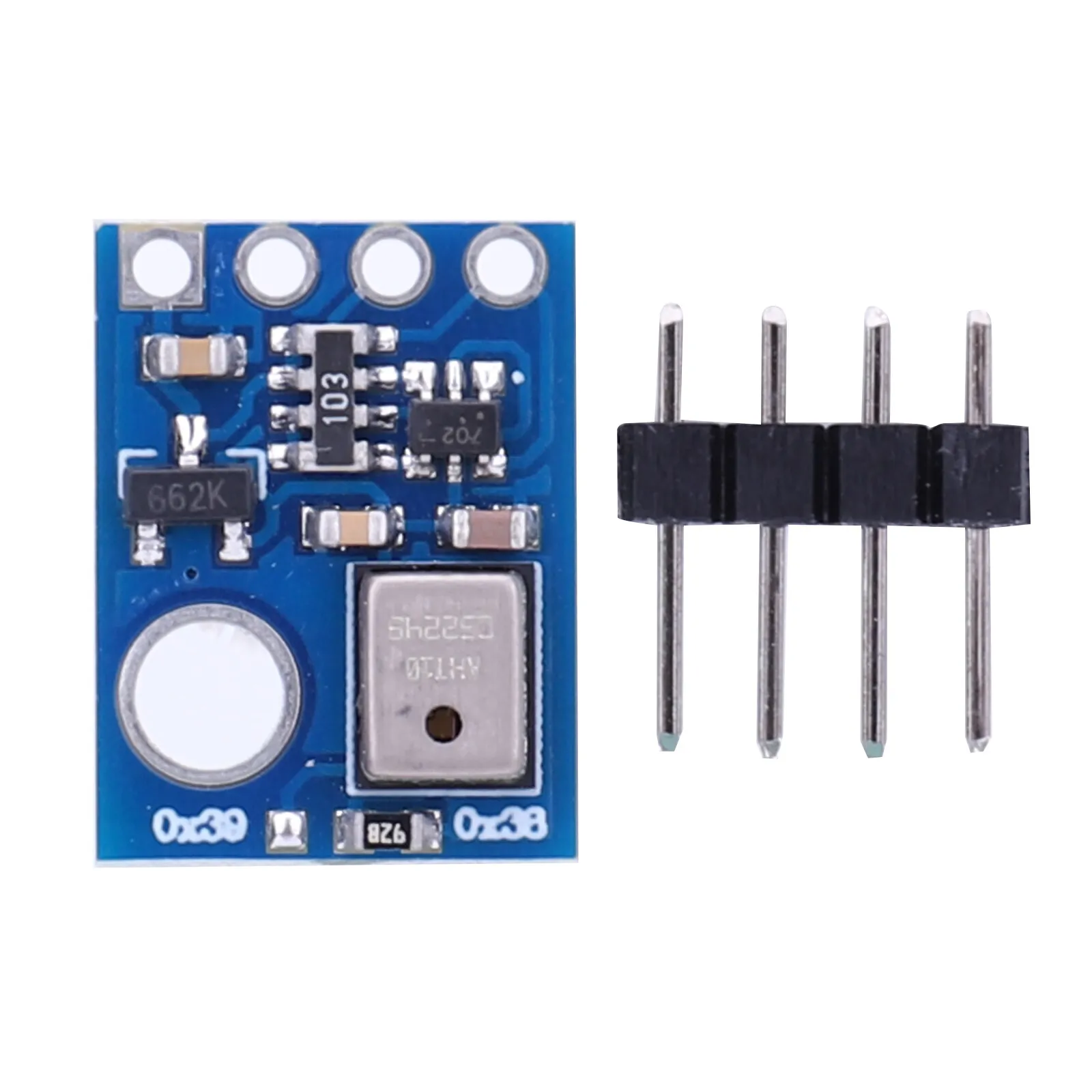

There are many temp/humidity sensors which are i2c such as sht21/31. Unfortunately, with most models, only one can be connected to the bus at any time. This problem can be solved using an i2c multiplexer, but that's not very convenient.
This type has a choice of 2 addresses, so 2 such modules can be connected to bus. Changing the address involves moving that small resistor at the bottom of the picture with a soldering iron.
Removing the resistor and soldering small wires from the pads to Arduino pins would make it possible to connect many such modules to the i2c port without the need for a multiplexer. But this is also not very convenient.
