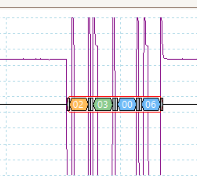

Hello folks, I have an interesting problem.
I have an RS485 sensor that communicates over modbus. When the sensor is connected to the PC via a USB to 485 converter , I send the sensor a request and I get a correct reply. I then connect the sensor to my Arduino (WAN 1310) , send it the same request frame and I get the correct reply back. Strange thing is, this nice behaviour only works with the sensors default address 01. As soon as I give the sensor any other address, it communicates well on the PC (I send a request and I get a correct response) but I get no response what so ever from the Arduino.
I used my oscilloscope to read the modbus messages and as you can see, when the address is 01, I manage to send a request and get a valid reply back. But, as soon as I change the address to 02, say, only the first four bytes of the request are transmitted, the other four bytes are missing, and, as a consequence, I get no valid reply. Has anyone come across this behaviour before or has any idea of what could be going on? If so, if you wouldn’t mind sharing the details on how to resolve the issue, that would be much appreciated. Thank you.
