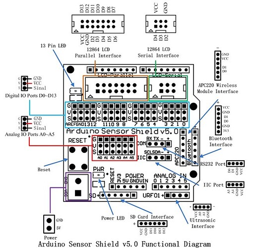

I have purchased Sensor Shield V5. There are TXRX pins. I want to attach bluetooth with that. Can some one tell me what are the pin numbers of TXRX.
From the picture? I'd say its the ones in the middle of the board. If you want to determine how to address those pins from the Arduino code, you need to post a link to the board, where the schematic can be found.
From that picture;
What are the bluetooth pins down the RH side?
That should help, google and ye shall find.
Tom... :slight_smile:
I am seeing TX RX - + pins. Please tell me what the pins numbers. Like Digital pins numbers are like 0,1,2,3 to 13. How can i call TXRX pins in Arduino Code.
The picture that TomGeorge posted shows that RX and TX are connected to D0 and D1.
