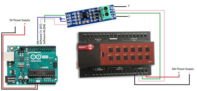

If You can post a wiring diagram, showing the IC pin symbols and wires we will less likely misunderstand each other.
DO I read as Data Out and connecting it to an Rx is correct. DI, Data Input, the same.

Here is a wiring diagram:
(Click here for enlarged image)
As you can see, I left the VCC and GND of the MAX485 with a question mark.
Based on the data sheet, it seems that VCC must be Positive Supply: 4.75V ≤ VCC ≤ 5.25V
So I must connect it to the 5V power supply.

Where is this minimum of 8 volts are going to come from when Arduino tries to send data (and not receive) if the MAX485 will be supplied with 5V?
The data sheet for your MAX-485 breakout board will show you where the voltages come from.
Paul
Check any wiring diagram about the little board to be shure but I need a GND beteeen the UNO and the luttle board. I believe that Vcc is, as You, say, the 5 volt, like the UNO.
That 8 - 32 volt I would say it's for the relays. It will safely handle both 12 and 24 volt relays.
@yanivps The GND and VCC of the MAX485 go to the GND and VCC of the UNO.
I too am wondering what the manufacturer was referring to when the quoted the 8-32V range. I hope they may have been referring to the DC supply voltage for the node, rather than V pk-pk of the data signal!
EDIT: I did see a picture of a 4-pin connector that had GND, D+, D-, 28V on it. Maybe they are referring to a DC supply voltage to operate the device.
That's the talk from the sales people. They usually mix up things or uses poor or wrong descriptions of engineering stuff.
The boards I have generate the +- 8.3 volts from the circuitry on the board, driven by the +5 volts and ground.
