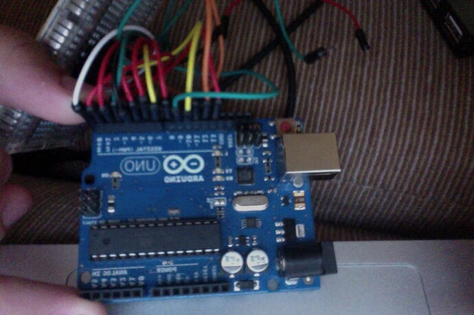

The serial port no longer shows up? Could be a problem with drivers. Or the USB-Serial chip is fried. Could you post a picture of your board?
Here it is, Sorry for the low quality. I believe it is actually the R3.
I can provide a higher res if neccassary

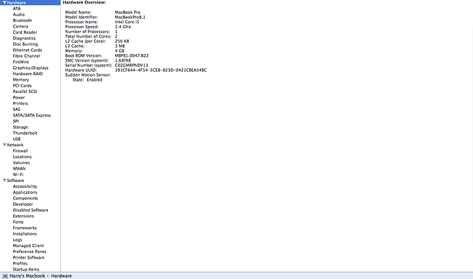

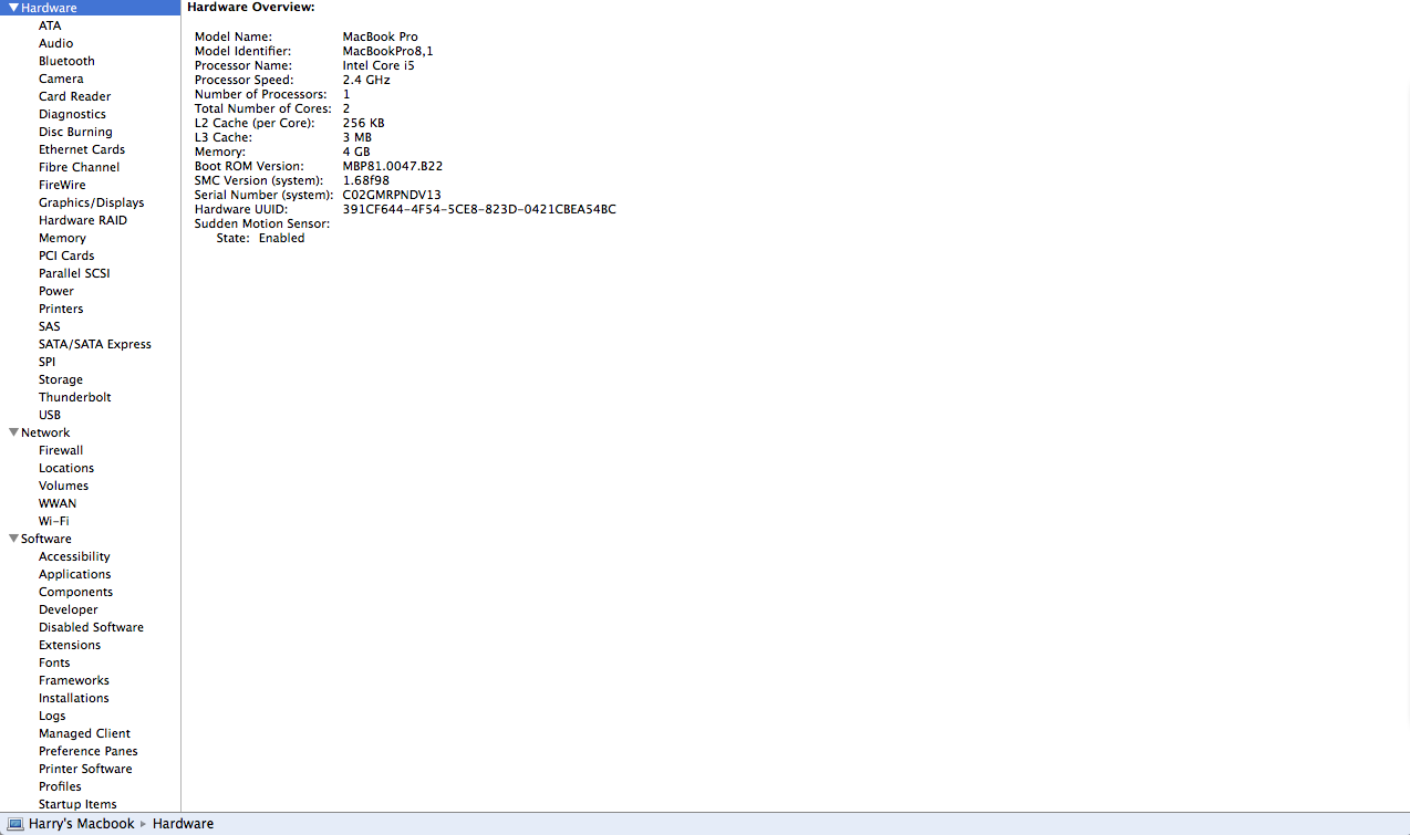

The picture is a little tough to read, since it is a mirror image. But I think it is a R3. Can you post a screenshot of Device Manager with it plugged in?
I could not find the arduino anywhere
If the Arduino was going to show up anywhere it would be under "USB". If it doesn't show up there your USB-to-Serial chip isn't working. You may be able to recover it by re-burning the firmware. You can upload the ATmega16u2 chip with Direct Firmware Update mode. Google for: Arduino DFU
