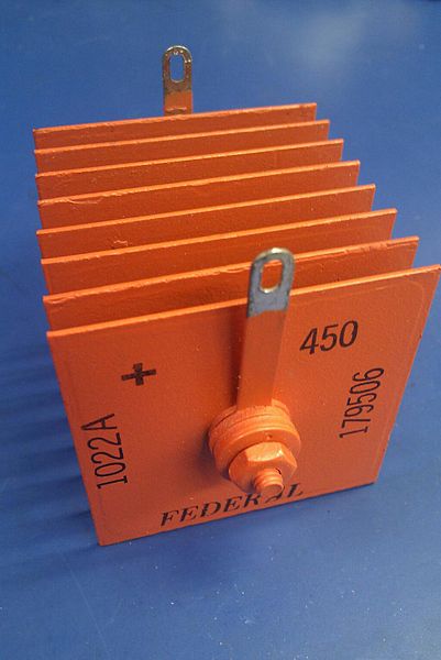

Ah, as a young teen building Knight Kits, nothing quiet said "poof" like a bad selenium rectifier!
