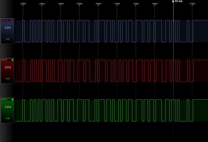

Okay, so I have done some tests and the results look reasonable though could be better.
Serial 9600 & Manchester
First image (black background) is from the signal generator, second image (grey background) is the capture using arduino.
1-Wire & I2C
Finally SPI clock & IR remote
First image (black background) is from the signal generator, second image (grey background) is the capture using arduino. The IR only has arduino image.
Most of them look pretty close, it dies on SPI and 1-wire by the looks of it. But the SPI is 2MHz isn't it? No chance there.

1-wire is pretty rubbish but with SPI you can at least see some structure. I think the ISR is taking to long and missing fine detail. Maybe the code can be optimized to improve this or maybe add a separate high speed capture mode.
