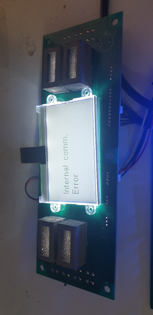

What I have tried so far, is use arduino as oscilloscope, capture the serial data, and send it to the back board.
[Front PCB] --- (data A) ---> [Arduino osciloscope] ---> (data A*) ---> [Back PCB]
But every reading is slightly different by 0.5ms, and have a slightly different pulse width and the Back PCB does not recognize the signal and give error.
I think I need to first find out the coffee machine's baud rate?

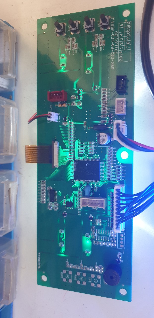

Hi zoomkat
I have very limited information on my coffee machine, and the coffee machine manufacturer won't disclose the datasheet.
I've attached some pictures for better visualization.
The front and back pcb has 1 set of wires ( 5v, GND, Rx, Tx) and that is the only wire that they use for communication. I've marked it with red circle in the attached pictures.
So finding out baud rate, and other things is my task, which I need help with :frowning:
If the communication is a rs232 variant, then you might be able to use an arduino as a sniffer, but there are other communication protocols that might be in play. What is the resting voltage on the tx and rx lines?
Resting voltage on Rx, Tx line is 5v.
Edit: Resting as in if there is no data, then it is at 0v, and when data is transmitted, then the voltage goes up to around 5v.
