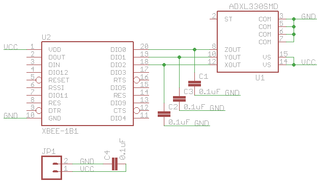

This is what I plan to do with it
But instead of sending data to PC I will send it to another xbee.
http://www.faludi.com/itp_coursework/meshnetworking/XBee/XBee_example.html
So probably try to just connect them with LED first.
