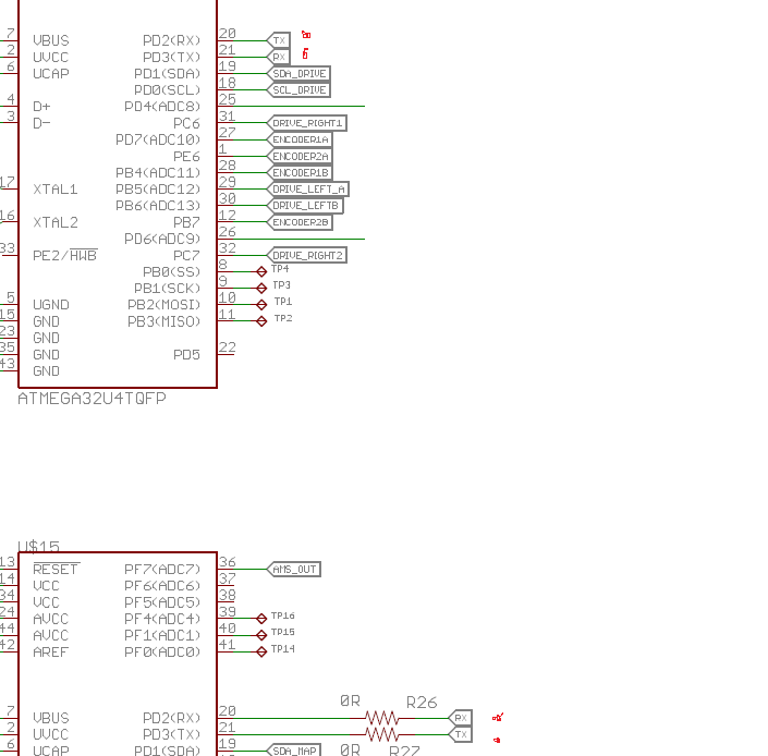

I know this is a common question on how to communicate between two arduino's using serial, but i can't figure what is going on. I've attached my schematic portion on how the two are connected. I can confirm that there is an electrical connection between the two. I've connected TX to the RX between the two.

i'm not sure if since the atmega32u4 has its USB priority, would it effect any data. on the arduino website it says
The Arduino Leonardo board uses Serial1 to communicate via TTL (5V) serial on pins 0 (RX) and 1 (TX).
ive also tried swapping serial1 as write and read without any luck.
does anyone have any idea whats going on?
thanks a bunch!

Thanks for your response.
I solved it using serial1. Turns out I forgot to initialize it.
You should also check Serial.available() before you try to read from the serial port.
And you need to connect the grounds of the two boards (if they aren't already)
