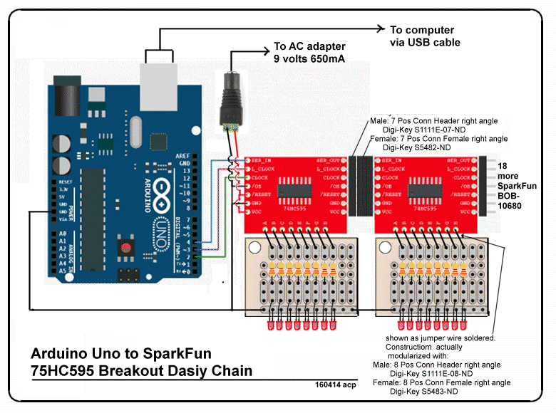

Connecting an Arduino Uno to a daisy chain of 20 SparkFun 74HC595 breakout boards (BOB-10680)
using this layout.

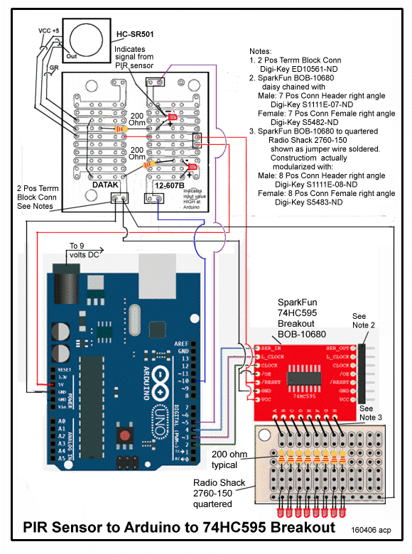

With the daisy chain connected directly to the Arduino as shown in the first untitled GIF and all 160 LEDs sequenced perfectly.
Then the PIR circuit was added and the first ten shift registers work as intended but the second ten
registers blink faintly at about ten hertz until it is time for them to come on
in the sequence and they operate as designed.
So I was talking to a buddy at work and he said that the Arduino is really not designed to handle more than six or so LEDs using the 5 volt source on the Uno and that I should connect the LEDs directly to a heftier voltage source and make sure that all the grounds are connected so I tried this setup.
I figured I would get the display to work and add the PIR sensor later.
This causes the 160 LEDS blink on and off at a bout .5 hertz.
Also tried connecting the breakout board to a nine volt
battery. This resulted in the LEDs to coming on and staying on.
It seems that powering the LEDs thru a source separate from the Arduino causes
the LEDs to ignore the Arduino program and just come on.

Look in the datasheet of the chip. What is the voltage required on the signal pins? Hint it's not 5v
Mark

Chaining so many boards may overload the clock pins. If 10 boards work fine, split the chain into 2*10 boards, connected to different pins.
You should have looked in the datasheet for the 74HC595. Like the vast majority of data sheets it gives the values for the input signals WRT Vcc Your diagram shows you feeding the 74HC595 9V.
Lines long enough to connect to that many 74HC595's will give lots of problem on all the signals.
