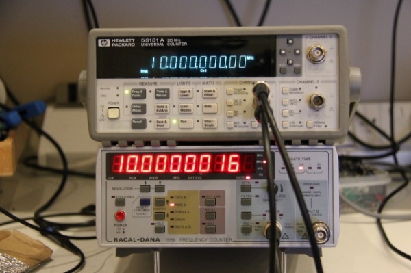

The crystal of the Arduino is not very accurate. What if the mechanical watch is more accurate than the Arduino ?
It is possible to tune the crystal frequency with a register, but I think that it will not be accurate enough.
According to this, there are used heated crystals that are very accurated:
You can use a RTC (Real Time Clock). Is it okay to measure during an hour or so ? That would make it possible to measure it.
The mechanical watch depends also on temperature I assume. And perhaps baromic air pressure. So the tilted effect is perhaps not the only thing that is measured.

It is going to have to be. Given the mechanical restraints of simply coupling a microphone to the watch (I seem to recall this sort of watch tester from thirty-odd years ago, using a "radar"-style display!), you will need a long averaging time.
A RTC module as time reference would certainly be the way to go, but since it only reads out to the nearest second (IIRC), you might want to actually count its 1 second "ticks" and synchronise with them.

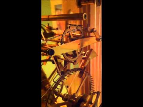

Id certainly be interested in this. My version was simpler because I was looking at a clock, I didnt need to "listen" to the beat but could physically measure the pendulum swings by a laser break or similar "button". Im still interested in doing this as Id love to know how accurate my clock is!

Before you get into the details of how to implement I suggest you think about what sort of timing resolution and accuracy you need. If you want to know whether it's 4Hz or 18Hz that wouldn't be very difficult to tell apart. If you want to know whether it's 3.9999999999 Hz or 4.00000000001 Hz, that's a different matter.
