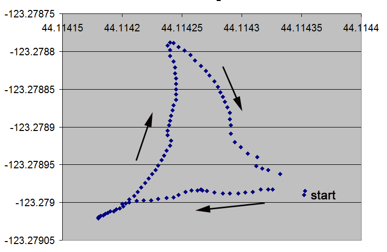

A couple of years ago I modified a toy RC boat (50 cm LOA) with twin screws to navigate between waypoints. The hardware was a Pololu Orangutan LV168 Arduino, with built in motor controller, a GPS module and a BNO055 absolute orientation sensor to determine the heading.
In the test below, the boat notes its initial location, projects two GPS waypoints forming an equilateral triangle 60 meters on a side and then navigates that course to return to the starting position. The BNO055 is required for steering the course and to compensate for wind, which as you can see in the movies below, severely affects this small boat.
This was all fit into 16K of flash memory on an ATmega168 (half that of the standard Arduino).
MP4 movies of the boat navigating a course (the second link was taken under fairly windy conditions):
The boat keeps a log file of GPS locations and other data, allowing a detailed course log to be plotted. The second run is shown below:
