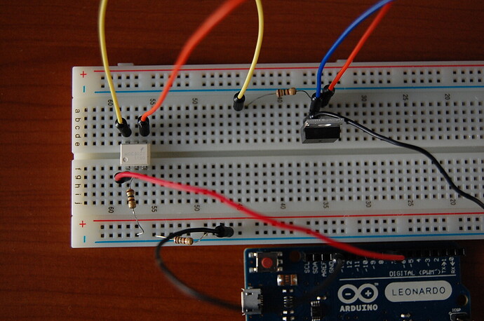

Here are some pictures:(I removed the AC power and the lamp)
The 2 resistors that connect to arduino ground and the moc are each 100 ohms(I didn't had one 200 ohm resistor)
The black wire from the triac is connected to A1, to A2 the blue wire + the 100ohm resistor from moc and to G the orange wire that comes from the opto-isolator.

Why is there a 100 ohm resistor connected to two points on the ground buss?
The resistor connected to A2 on one end is not connected to the opto on its other.
There is a yellow wire in the slot adjacent, but there's no connection that way.
Yes, that was the case, I corrected it and now it works! Thank you so much! And also thanks to the other users that tried to help me. I can't beleive that I missed it. All this time I was suspecting the triac, and it was a bad breadboard connection, pfff.
