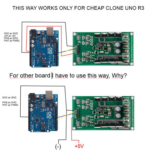

I connect the arduino uno to a H-bridge, (simple sketch, 5sec fwd, 2sec pause 5sec rev)
bridge has 4 input pins: "dir" "PWM" ; +5V and GND
I use
pin 7 to PWM
Pin8 to DIR
+5V to +5V
Gnd to GND
When I use a cheap chinese clone Uno R3 this works as intended
Now the Problem/question:
When I use a Different uno (without ch340) or a sainsmart mega and connect the exact same way using same sketch this does NOT work. only the led on the arduino is flashing once a second.
Why?
When I connect an external PSU to supply +5V /GND to the bridge input pins and additionally connect only GND from arduino to GND of the bridge this works as should - same for the mega.
I was thinking the bridge needs too much current - but the additional external PSU on the input pins of the bridge draws only 18mA... so not much current is needed.
I also checked if the sketch is running ok by measuring the output of the pins 7, 8 against GND of arduino with an oszilloscope, (without connected to bridge. signal is fine pins supply the correct
But when I connect to the bridge using only the arduinos +5V/GND it doesnt work
But it works fine with the cheap UNO R3 clone....?
For motors and motor shields never use the power rail from the board.
But do always have a shared ground.
Different boards especially clones are often built using cheapest components and there may be variations in the design to keep the cost down. They dont always perform as a REAL one would.
