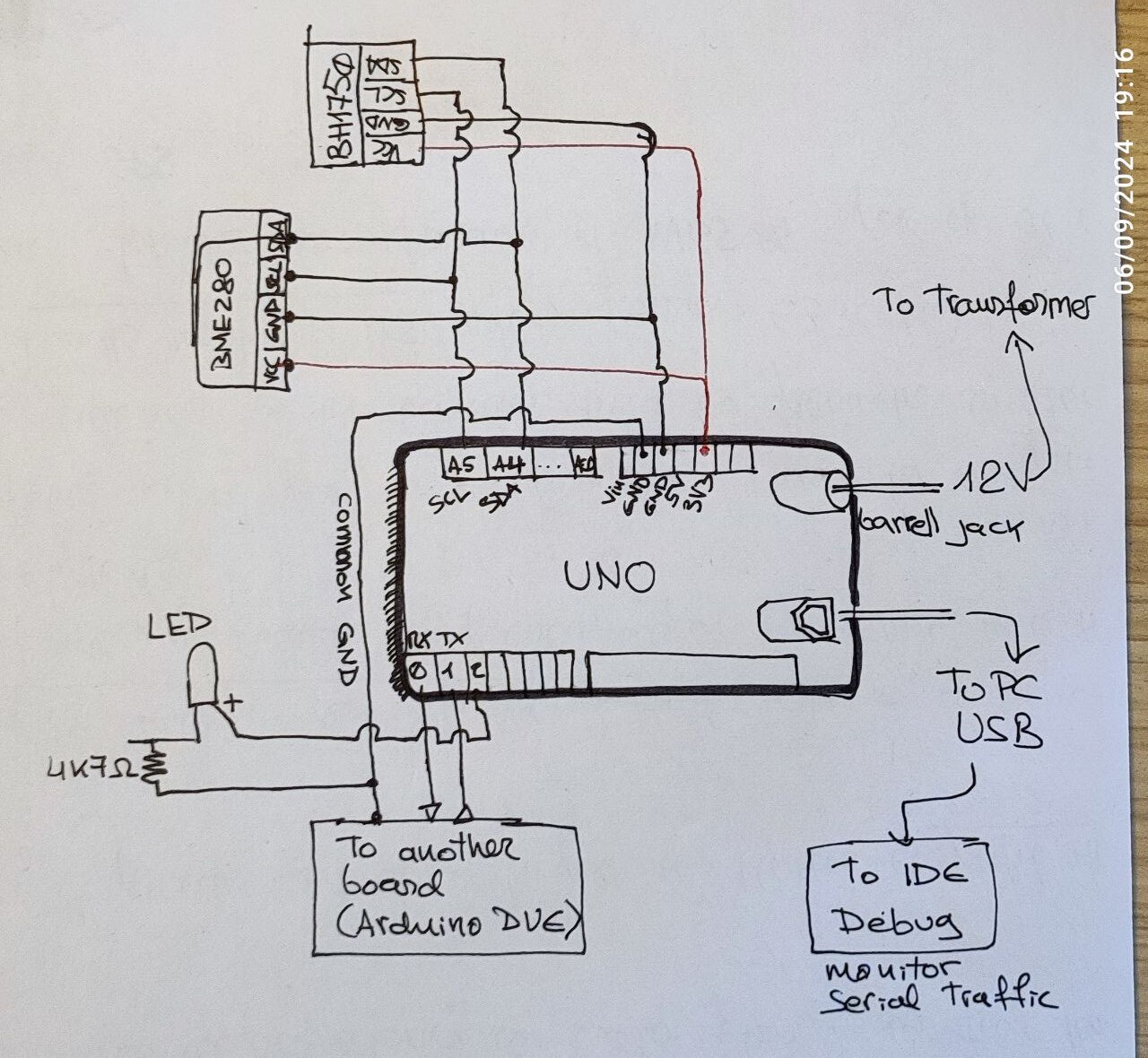

It depends on your sensor module if it should be powered with 5V or 3.3V. We need links to all your modules and board and a photo with the wiring and a schematic/circuit (you can draw it on a piece of paper) that shows the wiring.
Explanation: The Arduino Uno expects at least 3.5V on the I2C bus to see it as a "high". A 3.3V sensor can not give that. It will work, but the noise margin is gone. Pullup resistors to 5V can leak 5V into the sensor (via SDA and SCL) and lift the VCC of the sensor towards 5V. Some sensors are sensitive for that.
Explanation more: When a module is powered with 3.3V and there is a voltage regulator on that module, then the sensor might get 2.3V.
The I2C bus can not deal with cross-talk between SDA and SCL. They should definitely not be next to each other in flat ribbon cable. They are weak digital signals.

So this is basically my setup
What are your doubts ?
I really need to know the sensor modules to say something about the voltages.
The "GY-302" has a voltage regulator but no I2C level shifters. It is not suitable for a 3.3V board and it is not suitable for a 5V board.
In case you think that it can't be wrong if everyone is selling it, but you have to trust me :innocent: It is wrong. It will work (sometimes) when it is the only sensor on the I2C bus and that is exactly the problem that you have.
The "BH1750" works best with 3.3V power and a I2C bus with 3.3V signals at its SDA and SCL pins.
Are RX and TX connected to a Due ? But the Due is a 3.3V board. The Arduino Uno can push up to 40mA out with the TX pin, and the input clamping diodes of the ATSAM processor on the Due have to deal with that.
We often recommend to use a single Arduino board and add extra hardware for more I/O pins. What is your project about ?
I would definitely go with demo code like proposed on post11. Result of that would give indication if issue is code or hw related.
Do you think testing the example on another board like , arduino r4 minima would be a valid test? I intend to test the example as you suggest
