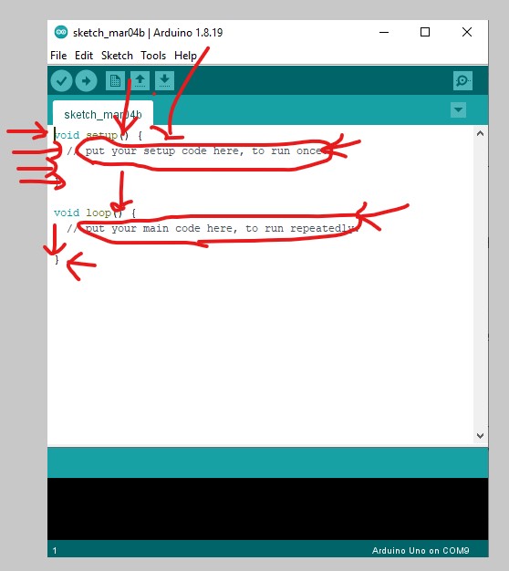

Will someone point me to a tutorial for the BASICS of Arduino? The internet is flooded with tutorials, but the water just keep getting muddier. Thank you in advance.
I have questions like...
Where exactly do I paste the code? Here is what the window looks like. The arrows are my options.

The picture literally tells you where to put your code.

Arduino was conceived to be easy to learn and flexible to implement but has become rather complicated through evolution and 3rd party hardware and software. To begin, you need to address what do you want to learn; example: digital electronics, programming, data gathering using sensors, games, of just fooling around with LEDs, motors, robotics, and so on. So, let say you want to do a bit of it all!
Before you start using the IDE software to build your own programs (your screenshot is the default 'new' sketch template) start by looking over the built-in examples:
Anything stir your interest? If so, you can bring up the example and Google to find info concentrated in that area, including YouTube videos. If I start with "Basics" I see:
As I have nothing but the Arduino board, I will select "Blink" and I get

  • To make the example work, I must connect the Arduino by USB to the PC,
  • Select the hardware port
  • And select the board type.

In answer to the original question, 'here' means between the pair of curly braces
setup() {
your code goes here
loop() {
and here
The symbol // merely signifies a comment, that is, non-code explanatory information for humans.
