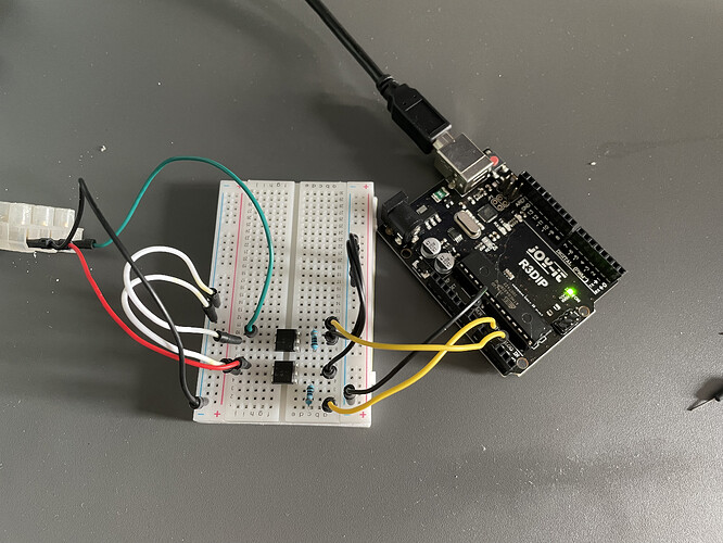

So here is the code I am testing with:
const int pin_focus = A1;
const int pin_shutter = A2;
pinMode(pin_focus, OUTPUT);
pinMode(pin_shutter, OUTPUT);
digitalWrite(pin_focus, HIGH);
delay(3000);
digitalWrite(pin_shutter, HIGH);
delay(400);
digitalWrite(pin_focus, LOW);
digitalWrite(pin_shutter, LOW);

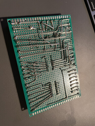

With my original board it did still not work.
So I build up a new testing circuit (with 390 ohm resistors):
and guess what, it is working now as desired!
So I do need to fix my board - but I think making it completely new might be easier...
Yay!

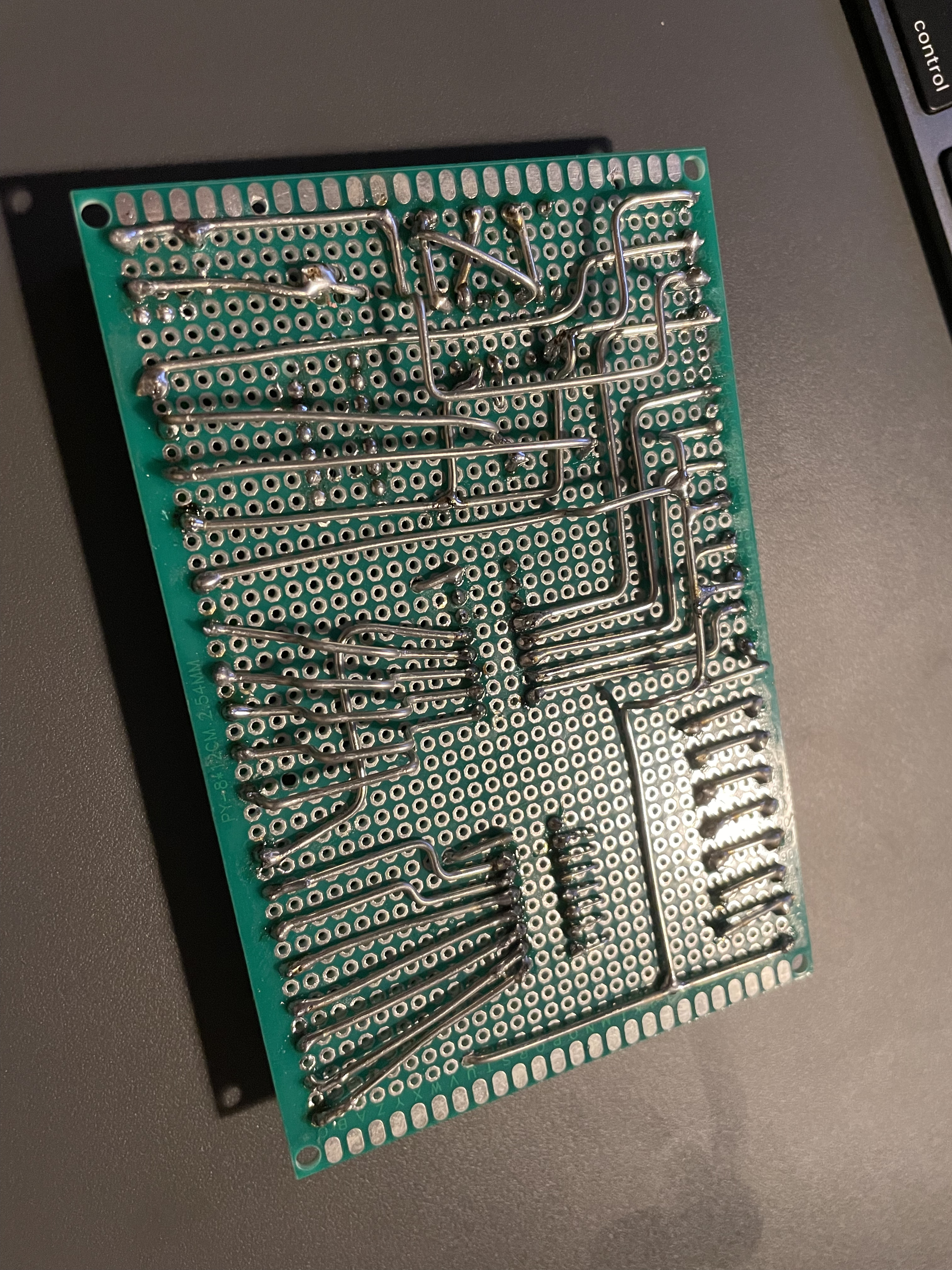

For everyone who is interested, this here was the old - not working - board.
(to my defense, it was the first time ever in my life that I soldered a circuit board...)

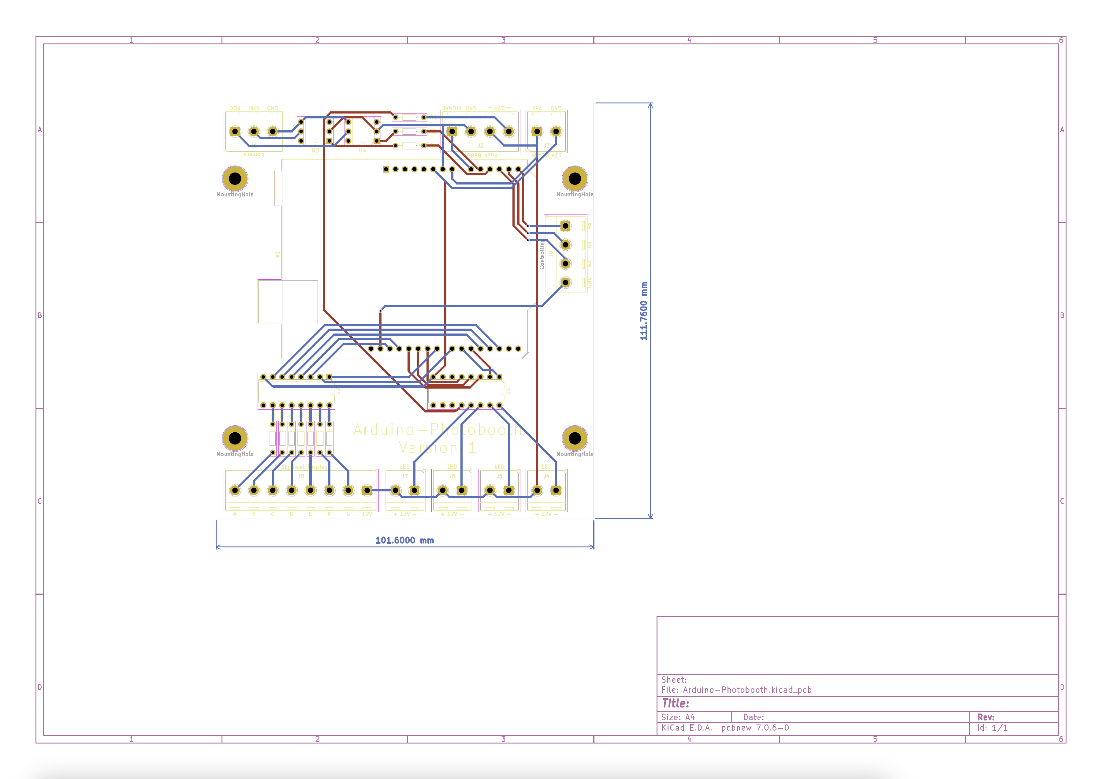

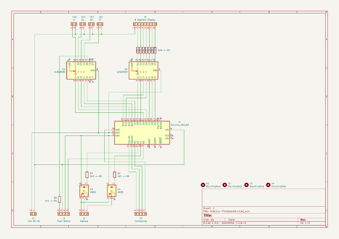

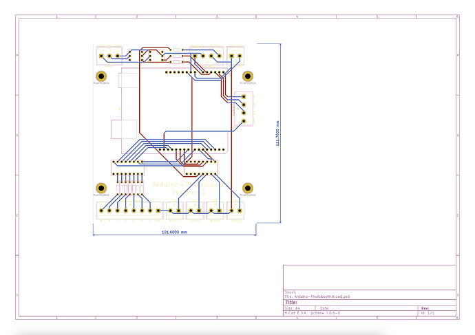

To avoid this kind of problems I decided to make the next one much more professional and so I got into KiCAD (with the help of a good friend who is well experienced with that programm) and the new board will be produced from a professional company.
I will let you know how it went as soon as the board arrives from china.
If someone is looking for a similar board, here is the KiCAD Project:
Arduino-Photobooth.zip (1,2 MB)
