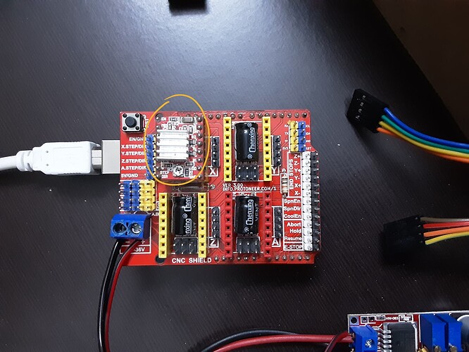

I have connected with cnc sheild on top and supplied a 24w power supply to shield, it was working when i bought

Well, shield was connected to 12v 2 amp supply as it would be required to power a 0.5w laser module

As you said that all you did was plug the shield in then that would suggest the shield is either damaged, incompatible, or the links have not been configured correctly.

Tried using another arduino board, the shield was damaged, which caused arduino uno board to fry,

So can you at least send a photograph of the shield?
I had some issues with power input points on shield, its was loose, would swivel when screws were lightly tightened

I have connected cnc shield and laser module via buck convertor to common power supply (12v 2amp)
I have used new arduino uno & cnc shield paried with old stepper drivers, once again same issue of over heating of arduino board repeated
After testing i have found that one of stepper driver's heat sink is getting heated as soon as connected ( even when when stepper motor pins for that section is removed)
So i removed all connection of shield and tested current consumed by cnc shield connected one stepper motor driver at a time, and the one that was getting hot would show consumption of 10mA and when connecting only seconds driver to shield it consumes no power
Conclusion found - if nothing is connected to shield then power consumed by shield should be zero, but with one of driver it shows 12v 10 mA consumed, does it means that there is short ckt in one of stepper driver ?
