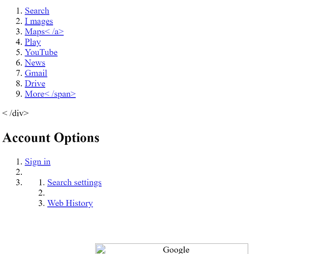

My primary objective is simply to confirm that the example project functioned properly and actually retrieved the web page in totality. I was trying to verify this by extracting the HTML portion of the serial monitor output and putting that into an HTML file to preview, however VScode flagged a high volume of syntax errors. I am hoping to understand whether any characters actually got lost in communication somehow (seems less likely), or otherwise if any other particular step of the example project and/or my post-processing would account for the syntax errors (seems more likely). I'm of course highly confident that Google works properly as-is!
To add to my original post, I have captured some of the syntax errors from VScode in the screenshot below - it is expecting ' at the end of line 8, and it also takes issue with all of the , in the subsequent lines. I tried to compare with Google's HTML on my desktop using Chrome's developer tools, but it looked fundamentally different - if I'm perhaps getting a mobile version of the webpage over the ESP32, I haven't yet found anywhere to view the mobile source on a browser to compare.
Barring any immediate insights from this forum, I will probably be doing more research into how a browser would handle a similar request, for comparison. In the meantime, I'm hoping that someone might have insight into why these syntax errors are present.
I'm not working on a specific project right now - eventually I might try to do a some kind of web server application for home automation, but for now I'm just trying to learn some basics about networking and get some experience with the related Arduino libraries.
Thank you!
An update - I removed the code from the Arduino example project which wraps the serial output at 80 columns (adding extra printlns - definitely interfering with the syntax). The HTML preview looks much better now:
There are still however 41 errors logged in VScode, mostly for css identifier/term/property value/{ expected. I may have to do a little more reading to try to understand the impact of those errors (are they "real"?). I'll share the corresponding html and error log info in text files here in case anyone is interested in taking a look.

putty.output2_txtfile.txt: Line 4, near character 1970
DXImageTransform.Microsoft.Blur(pixelradius=5);*opacity:1;*top:-2px;*left:-5px;*right:5px;*bottom:4px;
*opacity, *top, etc. do not appear to be legal identifers but maybe this works on MS browsers. Why google.com returns MS specific HTML when the http request is from an Arduino is a mystery to me. Unfortunately, big tech servers may return different HTML depending requesting browser, OS, source IP, etc.

An easy way to download the HTML response is with telnet (on Linux and Mac, or with WSL on Windows)
$ telnet www.google.com 80 > google.html
You won't see anything after pressing Enter. Type the HTTP request. One trick -- which also works when performing HTTP with Arduino -- is to use HTTP 1.0. You don't have to manually close the connection -- 1.0 does not support keep-alive, and you don't need a Host header. There's also no Transfer-Encoding: chunked for the response, so no chunk sizes. Just the request-line followed by a blank line
GET / HTTP/1.0
You should get Connection closed by foreign host. and the shell prompt. Edit the file, and remove the response headers, everything before the <!doctype html
I get 55,070 characters, but only 59 lines. Doing a Format Document in VSCode yields 1,679 lines. All the errors are CSS errors. The property names starting with an asterisk is apparently an IE7 hack. I gave up trying to find an explanation for the slash before semicolons for property values.
It's common to have a single set of HTML and CSS for with all the browser-specific hacks. Each browser would honor its own stuff and ignore the others. (Note that the request had no User-Agent header.) Browsers are better now, so don't follow those 20-year-old hacks. Stick to standard stuff.
