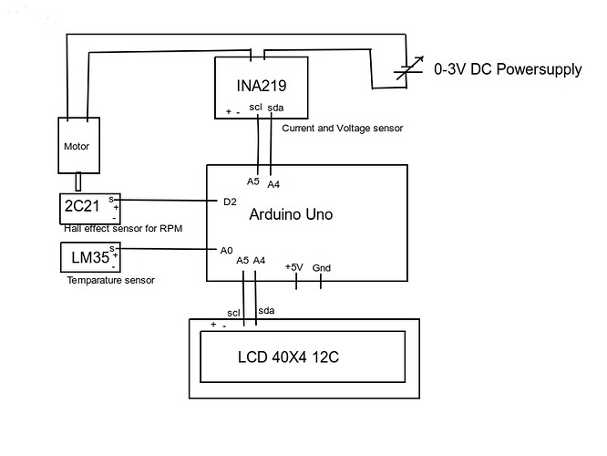

Hi Everybody,
I am making a project to sense and display 3V toy motor RPM, operating Temperature and Volts and current using Arduino Uno, 2C21 hall effect sensor for RPM, LM35 temperature sensor, INA219 for voltage and current sensing and 40x4 LCD with I2C Serial Adapter.
For the code, I am using a combination of several codes which I found online and this code looks like working too.

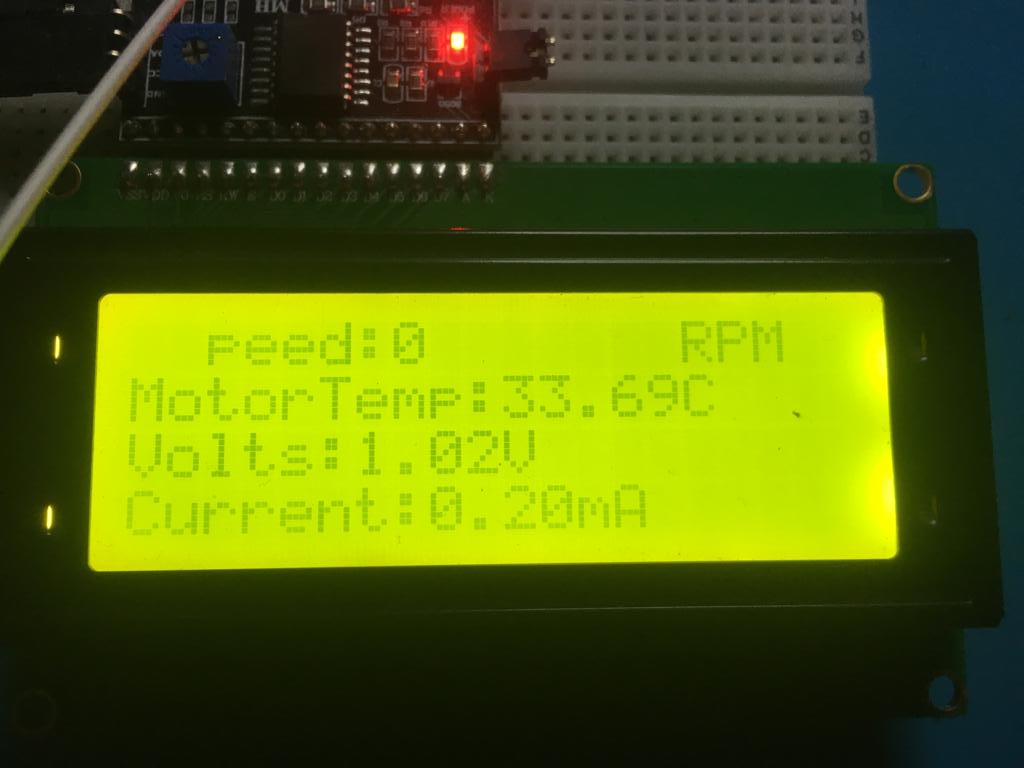

My problem is, (1) the display is not working properly ("S" is out from "Speed"), (2) and it's getting hang when I increase the voltage to the motor. (3)Also, it displays the RPM even when I keep the sensor away from the motor.
I really appreciate if someone can help me to fix these issues.
Thank you.

Please include ALL hardware, component names and pin labels.

Hope this will work, All the + and - connected to arduino + and -, Also I have used external 9V supply to supply arduino separatly.

Often that missing character at the start of a line, is caused by overwriting a ‘too long’ line further down the display.
LCDs are usually natively addressed as alternating lines , so maybe look at the code for lines 3 and 4 (2 and 3).

If you write too much in line 3, chances are it will wrap around to line 0 etc.
@lastchancename
Thanks for the advice, I remove some unwanted spaces and edit some code to reduce LCD char now char disappearing issue is fixed.

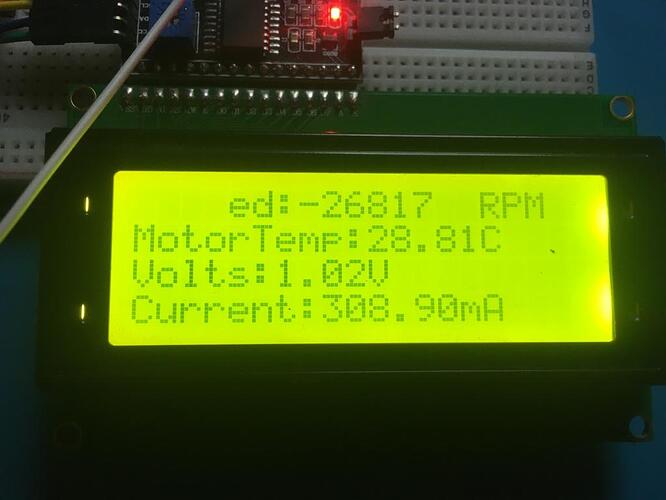

Hi, I'm using KY-003 Sensor. It is on the module, and datasheet for it is http://www.datasheet-pdf.com/PDF/KY-003-Datasheet-Joy-IT-1321960.
I add a 0.1uF capacitor across the motor terminals, but still it's the same, giving an RPM reading even without bringing the sensor near to the motor.
Where in your code do you pinMode the Halleffect sensor input?
It needs to have INPUT_PULLUP mode or you need to fit a 10K or 4K7 between the sensor output and 5V.
Can you please post your new working code please?
Did you try the example code in the data sheet you just link?
In my code, I don't have pin mode with INPUT_PULLUP mode, but after reading some other posts on the web, I added a 10K pull-up resister between 5v and signal. Also, I tried using INPUT_PULLUP mode according to the data sheet code after your reply, but still it's same.
Actually the Halleffect sensor is working correctly when I test it alone but when I add INA219 V and C sensor things going wrong, Also I found if I remove the signal pin from HE sensor false RPM reading also goes to 0.
Also, I found when I increase the motor voltage above 2.8-3 v LCD getting hang.
