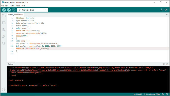

Thank you so much, I am trying to upload the sketch on my Arduino Uno and I am getting this error, any suggestions?
Start by posting you full sketch and full error message in code tags
In the meantime look at what is at the end of line 12
this is the error I copied from the sketch page
C:\Users\ravi1\AppData\Local\Temp.arduinoIDE-unsaved2023828-14072-1y4p916.b76d\sketch_sep28a\sketch_sep28a.ino: In function 'void loop()':
C:\Users\ravi1\AppData\Local\Temp.arduinoIDE-unsaved2023828-14072-1y4p916.b76d\sketch_sep28a\sketch_sep28a.ino:13:1: error: expected ')' before 'servo'
servo.writeMicroseconds(pwmVal);
exit status 1
Compilation error: expected ')' before 'servo'
This is line 12 in the code from post #3
int pwmVal = map(potVal,0, 1023, 1100, 1900); // maps potentiometer values to PWM value.
This is line 12 from the screenshot in post #9
Can you see the difference?
It worked, I was missing part of the code in line 12
