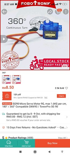

You picture clearly indicates the SG90 is a 180 degree Servo and NOT 360 degree Servo.

It can be common to "modify" standard 180degree Servos for continuous rotation, perhaps without changing the labels.
AFAIK, the idea that the "angle" used in the servo libraries has any effect on the speed of rotation of a continuous servo is ... spurious, and dependent on the electronics of the particular servo.
(the usual "continuous rotation" modification is to replace the position feedback pot with a fixed resistor divider. Sending an "angle" less than the divider set point makes the motor go one direction, and it moves the other way if the angle is on the other side of the set point. But whether the driver will move the motor slower or faster depending on "how far" from the setpoint the angle is, is questionable.)

This is the screenshot of the item on online ecommerce platform Shopee

I bought what I believe a 360 deg servo, and was told by the seller it is a 360 continuous servo. I am unable to tell the difference other than seeing how it move. I thought it should serve the purpose. If its not, then what do i have here?
