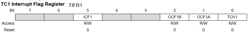

Untested Sketch:
volatile int speedPulseCounter = 0;
  pinMode(2, INPUT_PULLUP);
  //----------TC1 init-- for 3-ssec TimeTick----------------------
  TCCR1A = 0x00; //normal counting mode of TC1
  TCCR1B = 0x00; //TC1 is OFF
  //compute preset value (n) with clkTC1 = clkSYS/1024 =16525 Hz
  //0x10000 = n + 3*16525 (counts for 3-sec)
  // n = 0x10000 - 0xC1A7 = 3E59
  TCNT1 = 0x3E59;     //presetCount for 3-sec time dealy
  TCCR1B = 0x05; //Timer-1 ON with clkTC1 = 16 MHz/1024 = 16525 Hz
  attachInterrupt(digitalPinToInterrupt(2), ISRINTZ, FALLING);
  oneMinDelay();
  noInterrupts(); ///protect critical section
  Serial.print("Motor Speed: ");
  Serial.print(speedPulseCounter);
  Serial.println("/min");
  interrupts();  //re-enable interupt
void oneMinDelay()
  for (int i = 0; i < 20; i++) //1 Min
    threeSecDelay();  //3-sec timeDelay
void threeSecDelay()
  while (bitRead(TIFR1, TOV1) != HIGH)
    ;                      //wait unti overflow happens
  bitSet(TIFR1, TOV1);     //clear TIV1 flag
  TCNT1 = 0x3E59;       //reload preset value
void ISRINTZ()  //Interrupt Service Routine due to Interrupt type 0 (INT0 = INTZ)
  speedPulseCounter++;
The Registers:
TCCR1Ax
