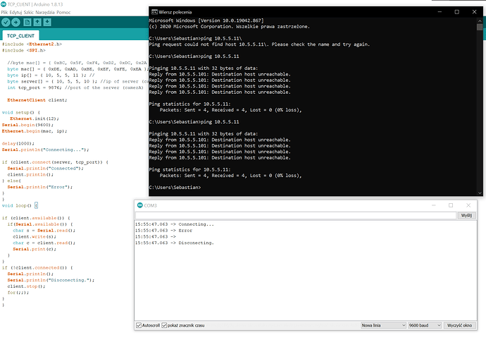

Okay so that's my code:
#include <Ethernet2.h>
#include <SPI.h>
  byte mac[] = { 0xBC, 0x5F, 0xF4, 0xD2, 0xDC, 0x2A }; //Mac of the camera
  byte ip[] = { 10, 5, 5, 101 }; //ip of pc ethernet card
  byte server[] = { 10, 5, 5, 10 }; //ip of server (camera)
  int tcp_port = 9876; //port of the server (camerA)
  EthernetClient client;
Ethernet.begin(mac, ip);
Serial.println("Connecting...");
if (client.connect(server, tcp_port)) {
  Serial.println("Connected");
  client.println();
} else{
  Serial.println("Error");
if (client.available()) {
  if(Serial.available()) {
    char s = Serial.read();
    client.write(s);
    char c = client.read();
    Serial.print(c);
if (!client.connected()) {
  Serial.println();
  Serial.println("Disconecting.");
  client.stop();
  for(;;);
I tried with mac adress of my ethernet card also (which one should it be?).
I get the messages:
13:54:54.851 -> Connecting...
13:54:54.897 -> Error
13:54:54.897 ->
13:54:54.897 -> Disconecting
Any thoughts?

Okay here's the picture. I can add that i tried again with TCPIPBuilder and everything is working properly.
I am starting to think t(if the code is ok) that it is something with my arduino.
I have uno3 +w5500 module SPI.
Okay quick update, I am pinging the arduino:
But still error.
What changed, other than ip address, to get ping working?
Do you know why did .101 reply when you tried to ping .11
.101 is my ethernet card ip
I changed ip adress and reconected the wires from W5500 (probably that was the issue).
But now it should work and i have no idea what to change more :smiley:
