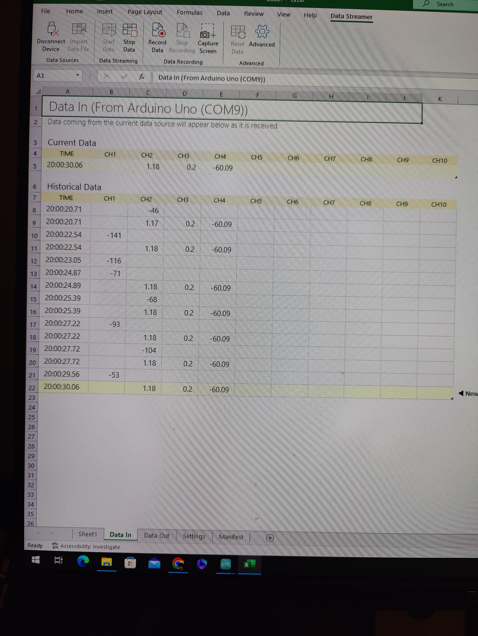

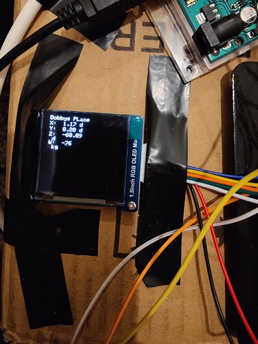

Hi all,
I already started a topic in the Nano section but because I moved to this board I am starting over here.
So I am trying to get data from WitMotion HWT905 TTL high accuracy 9 Axis AHRS Sensor
inclinometer. It has a written library from the manufacturer to get it going with Arduino Uno Rev3.
YouTube_Video
There is a youtube instructional video as well showing the steps and the way it has to be connected. I follow everything as per the instructions but when I load the library in the Arduino IDE and try to verify it before uploading it gives me an error.
I am starting just now with learning the coding and it seems a bit overwhelming so far I just can't find what I am doing wrong.
Can you guys give me some guidance on what could be wrong with that library?

HI managed to make it work on Arduino Wifi Rev2 and this is the code including a calibration in the beginning.
Now I am trying to stream live data to excel with excels live streamer but I cant make it print any data at all.
Does someone have any ideas?

Just to keep you updated with the progress guys.
I successfully connected a Waveshare 1.5in SPI-4 wire RGB OLED SSD1351 display to show the received data from the WitMotion HWT905 and also print the same data to an Excell sheet with Microsoft Data Streamer.
I had to switch again to another board cos of the better support. So the library bellow was created for Arduino Uno Rev3.
But my gut feeling is I`ll have to go to a bigger board because the Uno will run out of memory as I have two more sensors to connect and an ESP-01 module to send the data to the cloud.
This is the working code so far....Please if you see something daft let me know.

  display.print("Bobbys PLace");
  display.setCursor(0, 10);
  display.print("X:  ");
  display.print((float)JY901.stcAngle.Angle[0] / 32768 * 180);
  display.print(" d");
  display.setCursor(0, 20);
  display.print("Y:  ");
  display.print((float)JY901.stcAngle.Angle[1] / 32768 * 180);
  display.setCursor(0, 30);
  display.print("Z:  ");
  display.println((float)JY901.stcAngle.Angle[2] / 32768 * 180);
  display.setCursor(0, 45);
  display.print("W:  ");
  display.println(val);
  display.print(" kg");
