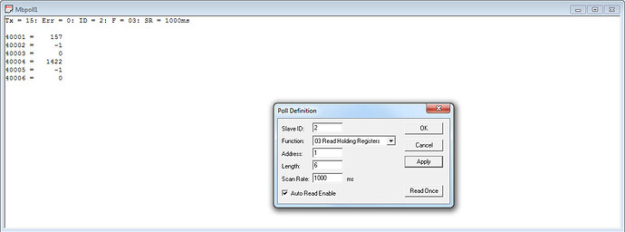

I'm trying to connect to a wind direction sensor via the Arduino Uno.
This sensor supports Modbus protocol. Connect the device to the computer and the modbuspoll software output :
This code:

I have a problems : I get error code 83
Provide a link to the datasheet for the sensor.
Your Modbus Poll screen picture shows 6 registers which are presumably 2 bytes in length, so 12 bytes in total.
Your Arduino code only deals with 8 bytes.
Where do you see the error code 83 message, in the Arduino Window or Modbus Poll?
Curious. Everything looks okay, not sure why you get the 83 error response.
Have you trying reading address 1 for 2 words with modpoll to duplicate your software serial request?

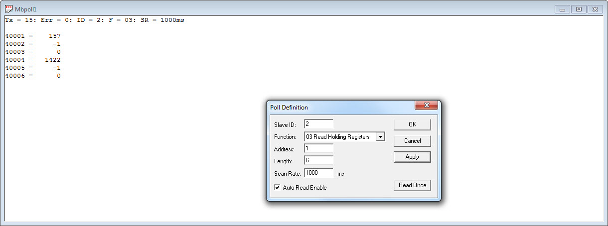

I will receive this error code in response to an Arduino request (picture 2)
2 83 3 F1 31 0 0
I put the modbus poll to test the registry address.
I put different addresses in the program, such as 0 to 1 or 1 to 2, and I also changed the crc code but the device sends the same error code
this is my sensor link :
ES106 Weather Station Sensor Datasheet _ WoMaster.pdf (755.8 KB)
By default Modbus Poll uses "base 0" addresses. If you change it to "base 1" to match the documentation you get 02 03 00 00 00 02 C4 38.
