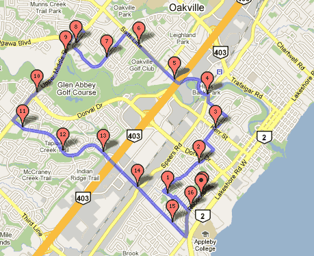

Insert WiFi signal data into SQLite
http://forum.arduino.cc/index.php?topic=261296.msg1844386#msg1844386
Schedule Tasks on Linux Using Crontab
Add GPS data as enhancement, insert them with WiFi signal data.
http://forum.arduino.cc/index.php?topic=208117.msg1533957#msg1533957
Setup PRIMARY KEY and automatic timestamp in SQLite
Use Google Map draw the route.
