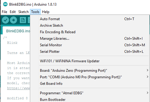

Hi I am using an Arduino Zero Pro and trying to upload using the programming port, however, I get an error which says the following
Arduino: 1.8.13 (Windows 10), Board: "Arduino Zero (Programming Port)"
Sketch uses 23496 bytes (8%) of program storage space. Maximum is 262144 bytes.
Global variables use 3536 bytes (10%) of dynamic memory, leaving 29232 bytes for local variables. Maximum is 32768 bytes.
Open On-Chip Debugger 0.10.0+dev-gf0767a31 (2018-06-11-13:36)
Licensed under GNU GPL v2
For bug reports, read
    http://openocd.org/doc/doxygen/bugs.html
debug_level: 0
none separate
adapter speed: 400 kHz
cortex_m reset_config sysresetreq
Error: unable to open CMSIS-DAP device 0x3eb:0x2111
Error: No Valid JTAG Interface Configured.
I followed the steps described in the https://www.arduino.cc/en/Guide/Arduino but upon installing drivers but I never got the message "Windows has finished installing Atmel Corp. EDBG CMSIS-DAP ", it was always recognised as a USB port.
I found out getting the board info through the Programming port that it is an M0 Pro, below is the complete details it returns
BN: Arduino M0 Pro (Programming Port)
VID: 03eb
PID: 2111
SN: FFFFFFFFFFFFFFFFFFFF
I did try to upload by selecting the proper M0 Pro board (Programming port) and the corresponding port and EDBG but still had the same error.
Based on some online help, I installed Microchip Atmel Studio which provided the drivers for EDBG Virtual COM Port, however, I still cannot upload anything using the programming port and get the same error. I saw many articles suggesting to change the boards.txt, but since this is SAMD21 board I am unable to find the information listed in the boards.txt under Arduino/hardware/avr/
How can I resolve this and able to use the programming port for upload?

Also, since my VID matches with the Zero Vid I used the "Arduino Zero (programming port) " for boards, and the Port is detected as an "Arduino M0 Programming Port", as shown below
