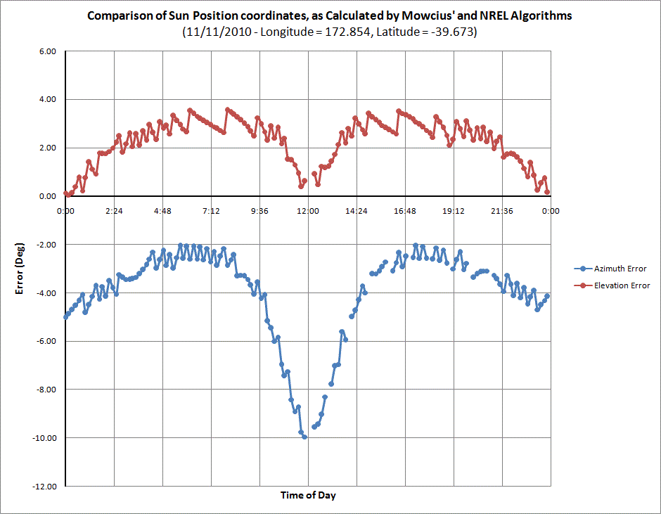

I've run through a little accuracy test of the sun position code I'm using right now, as provided by Mowcius. To check the accuracy I compared results calculated by Mowcius' code and the NREL online solar position calculator solpos (uncertainty of +/- 0.01 degrees). You can see the results here:http://arduinobeam.blogspot.com/
Mowcius' code does seem to suffer from some pretty serious error especially in azimuth angle around midday (~10deg).

I did the calculation every 10 minutes for the 11th of November using location data - Longitude = 172, Latitude = -39 (New Zealand).
The error does seem to follow a predictable pattern. Perhaps this is the result of additional effects not accounted for in the simplified calculation? Mowcius is your code based on the NREL code?
Hmm well my code was pretty much taken from someone else's code. No idea what that was based on.
I will take another look at what it gives me here at some point but like I said, it seemed to work fine when I used it before.

Right, a quote from the code I basically copied:
Blanco-Muriel from the Plataforma Solar de Almerýa (PSA) review the accuracy of all the algorithms. Further they develop a simplified algorithm that is accurate to within 0.5 minutes of arc for the year 1999-2015.
Well like I say, I have not had any major issues. Have you converted your lat and lon right to decimal degrees?

It would appear that Mowcius' implementation of the PSA 'sunpos' code or how it is being called that is causing the 'accuracy' problem.
The following code based on the same PSA algorithm generates data that is within 0.05 of a degree of the NREL algorithm.
Note this code uses (abuses?) the Arduino Time library for passing dates and times - this makes it easy to use a RTC and ask for the suns position for now()
Hope this helps

Here is the link to the NREL data corresponding to the default position and time in the code above.
http://www.nrel.gov/midc/apps/solpos.pl?syear=2010&smonth=11&sday=18&eyear=2010&emonth=11&eday=18&step=10&stepunit=1&latitude=-37.7926&longitude=144.932&timezone=0&press=1013.0&temp=15&aspect=180&tilt=0&solcon=1367&sbwid=7.6&sbrad=31.7&sbsky=0.04&interval=0&field=2&field=10&zip=0
Hmm well it will be less accurate due to the use of floats instead of doubles but I can't see much of a difference apart from that.
Any ideas as to what it is which is throwing it all out?
Mowcius
I can't put my finger on why there is the difference.
I came to your code via looking at the PSA site and my friend Google.
I saw you had removed / changed a few things like dropping off calculating per second and changing to floats.
I decided I wanted to start again with the raw PSA code and this is what I got.
