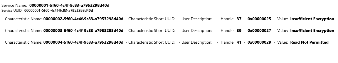

With The XBox one controller, the PC BlueTooth LE Explorer was able to show there are 5 services
and the like, and it enumerated the services and the like:
And for example, for the first 4 Services it was able to show data:
Service Name: GenericAccess
Service Name: GenericAttribute
Service Name: DeviceInformation
Service Name: Battery
Only when it got to the 5th Service, it was not able to give you all of the information:
On those the value looks like an error: ...
And then looking at my traces after it connects, until it shows that it failed, it looks like lots of messages were transferred back and forth between the two:

Attribute discovery failed!
Command tx ->  0x1 0x6 0x4 0x3 0x40 0x0 0x13
Next up, decoding the received messages and see if the current code is doing some form of all or nothing. That is if the code has properly identified all of the same data up to this, point but then fails to fully decode that last service, will it return the valid data that it has retrieved or will it error out the whole thing.
