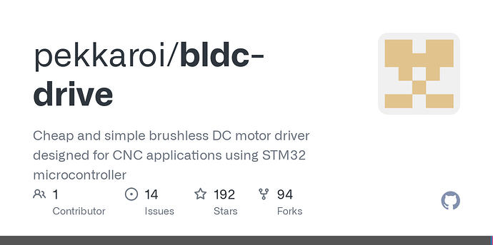

The target is an STN32F103, BluePill. I'm more of a mechanic; programming is a necessary evil for me. The program isn't mine, but from the internet.
can you share a link to that ?
Not clear to me, is your first target to be able to program that board (STM, not STN anyway) using the Arduino IDE (and therefore using Arduino C language and compiler)?
Anyway, if you need support about STM you must switch to the STM community forums or the Arduino for STM forum.
It’s clearly not meant for the arduino IDE. It’s pretty pointless to want to use it for this.
