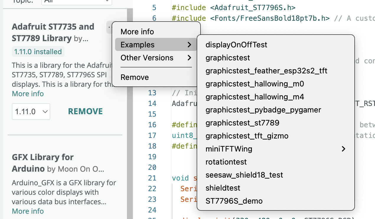

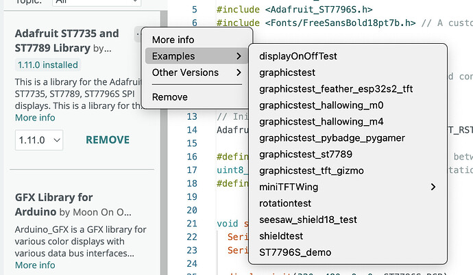

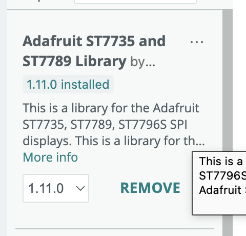

Try using this library and look at /try this sample
The last sample is for 7796
