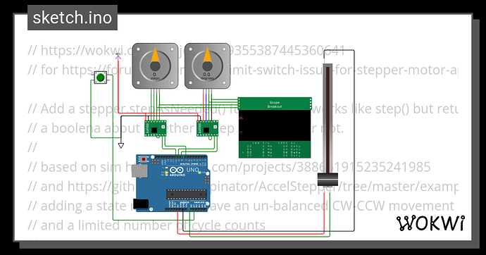

Here's a substitute to Accelstepper's stepper.step() function that indicates if a stepper actually made a step so it could be used for triggering steps on other axes:
class myAccelStepper : public AccelStepper
  public:
    boolean myAccelStepper::stepAsNeeded()
      // step as needed and return whether or not it stepped
      bool stepped = false;
      if (stepped = runSpeed())
        computeNewSpeed();
      return stepped;
    using AccelStepper::AccelStepper;
    using AccelStepper::setMaxSpeed;
    using AccelStepper::moveTo;
And a demo of using it to slave a second stepper to half-speed:
If you can know when the one fast axis does a step, you can slave a lot of cheap bresenham-ratio-controlled axes to the fast axis for coordinated motions.
