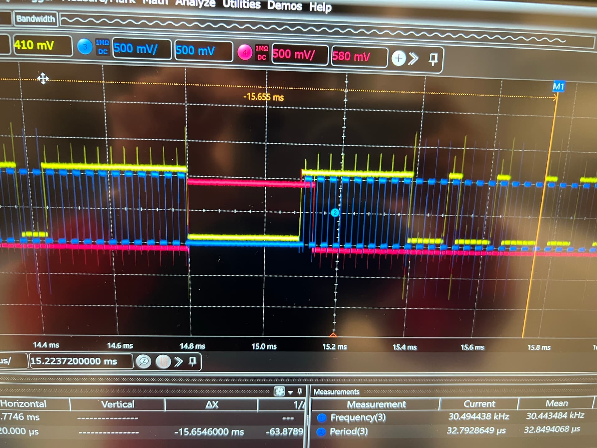

Hi, I want to generate 3 signals, which are SPI2, Clock, Latch in code part. I want to generate a faster clock period. But I can only use micros() to generated the clock period, when I set BlinkClock(time period of the clock) below 15us, BlinkClock = 10 for example. The outputs of three signals are not stable, clock period is totally wrong and will have overlap on my Oscilloscope which show on figure 1
. When I use BlinkClock = 15, which is what I expected in Figure 2.
So I think the micros() is not accurate enough in my condition. Since I want to get clock period into 2Mhz. I believe Arduino Due are able to reach that fast. However, I have found the solution yet.
Yes, I'm using oscilloscope. I want to get a faster clock period and able to read my digital data for faster.

Why don't you use HW-SPI? It's much more accurate regarding the timing.
That isn't really much for HW-SPI.
An attempt with micros() will never be accurate, because your other statements in the shifiting loop need time too.

Give us a link to that "I saw some Library " so we can check it out. I have code that would work, I just cannot find a processor that is fast enough. I highly recommend you spend some time and learn the basics of how the Arduino is configured and how the functions work. You will find that micros() and many other functions work because of background interrupts which is what is showing on your scope waveform.
