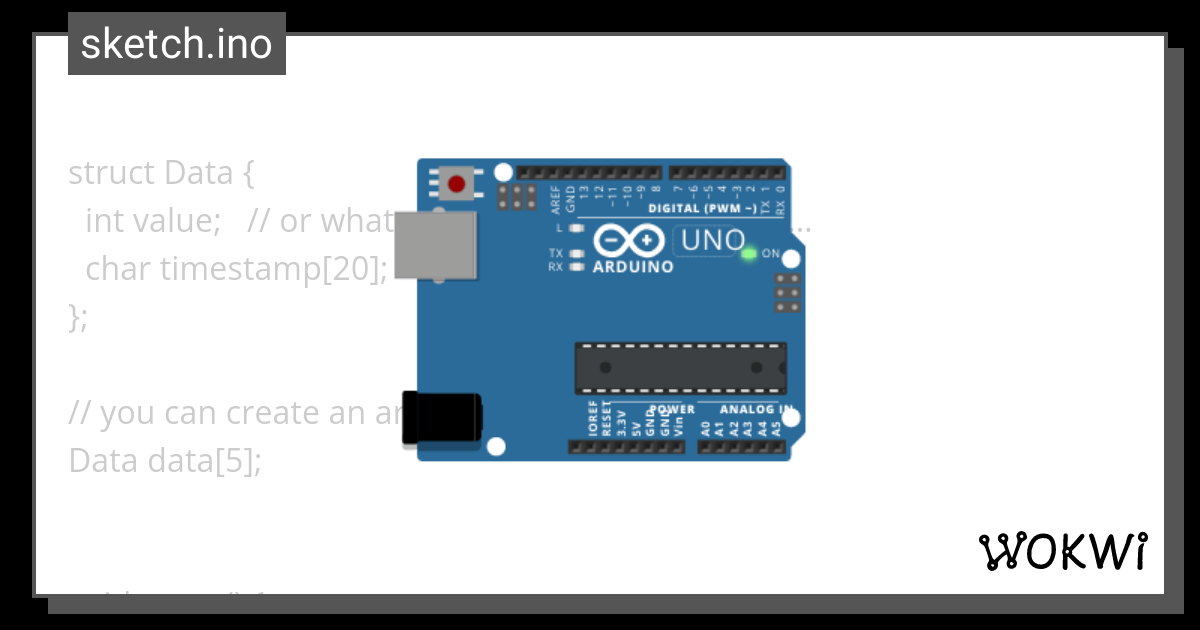

I propose to start with something like this
struct Data {
   int value;   // or what ever type is really needed...
   char timestamp[20];
// you can create an array with structure Data
Data data[5];

It works..
I'm so sorry maybe my question lil bit confusing, i just wanna know how to encode dynamic array to json, and that json i wanna send it to server.
I'm using your code like this :
struct Data{
  int id;
  char timestamp[20];
Data data[5];
void setup(){
  int val = analogRead(A0);
  for (int i = 0; i < 5; i++){
    data[i] = (Data) {val, "2023-07-05 11:20:29"};
  int sizeAr = sizeof(data) / sizeof(data[0]);
