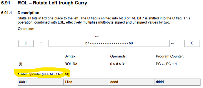

Oh, I forgot something.  It's neither here nor there but, the compiler/assembler apparently doesn't like the rol instruction in this bit of code.  It seems to prefer an adc .  I worked this up on WOKWI and it's easy there to see the compiled code.  I've noticed this before in other algorithms converted to assembly.
The effect is the same but since both take one cycle and one instruction I don't get the need for the alteration.

It turns out that ROL Rn and ADC Rn, Rn are the same binary instruction. The assembler should accept either one, but the disassembler will always show ADC.
It is "moderate amusing" how some manufacturers will leave out these "instruction aliases" (make the instruction set appear more minimal), some will explicitly document them ("isn't this clever! A NOP is just mov r8, r8"), and some sort-of hide the equivalences (as Atmel did for AVR.)
