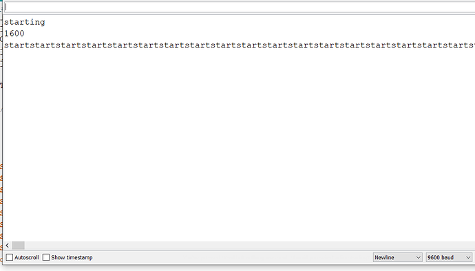

Ok so I am trying to create a good method for feeding an ISR the data it needs to generate a move profile for multiple stepper motors. I have all the parameters in a struct and created objects of the struct. later when trying to cycle through the calculation of the individual values for those object I used a for loop to go through the objects by putting the objects in an array called "joints", I want to print the values to the serial monitor so I can verify it is working correctly however, the code compiles but when I run it the serial monitor prints "starting" and then 1600 for c0 which tells me it is getting to the void function "targetPosition" but then it gets carried away and the data on the monitor speeds up and just starts spitting out half of starting before reprinting starting. I verified my monitor was working with a simple program running a serial.print s through a for loop and all was well so its my code somehow. Would be great if someone can point out my error of which I assuming it has to do with the assigning of the struct objects. below is the code and an image of what the monitor is doing.

@johnwasser the ISR is not coded yet to avoid the complication since right now I just want to make sure I am getting the values right that will feed into it.
@gfvalvo so I implemented your recommendation but the serial monitor is still doing what is was before any ideas on what would be causing that issue in the attached picture?
We can't see your current code.
CLaHue:
If you don't implement the ISR you should probably not enable the interrupt.
@johnwasser yes your right that's what was causing the serial monitor runaway symptoms. after that I cleaned the structure up and got it working however it is not saving the values of the struct after each iteration it dumps the memory once the targetPosition function completes. I need to get the struct to maintain the data from each iteration of the for loop so the next time it is called the parameters will be valid to the devices actual location. For this do I need to write a return method or is there a way to save that data to the heap verses like the stack which is what I guess I'm doing now since it dumps the memory once completed? ps not sure how to put code in the replies so I just edited the original post and updated the code there thanks.

@johnwasser ok I see what you mean and I think I did initialize them globally at the top, except for the axis array which can be discarded whose the function completes, I found a bone head mistake in my code, I never updated the actual position that I used to start the targetPosition function with so it was always subtracting 0 an hence looked like it was discarding the struct variables when completing the function. I added
//----------- joints_.actualPosition = axis*;------------------------------------------------------------------------// at the end of the function to up date that variable so the next time it came through is was subtracting from the correct value. thanks for the help though if you had not mentioned the initialization I wouldn't have looked at that variable. It is working as it should now so its on to the ISR! (next set of major problems haha )*_
