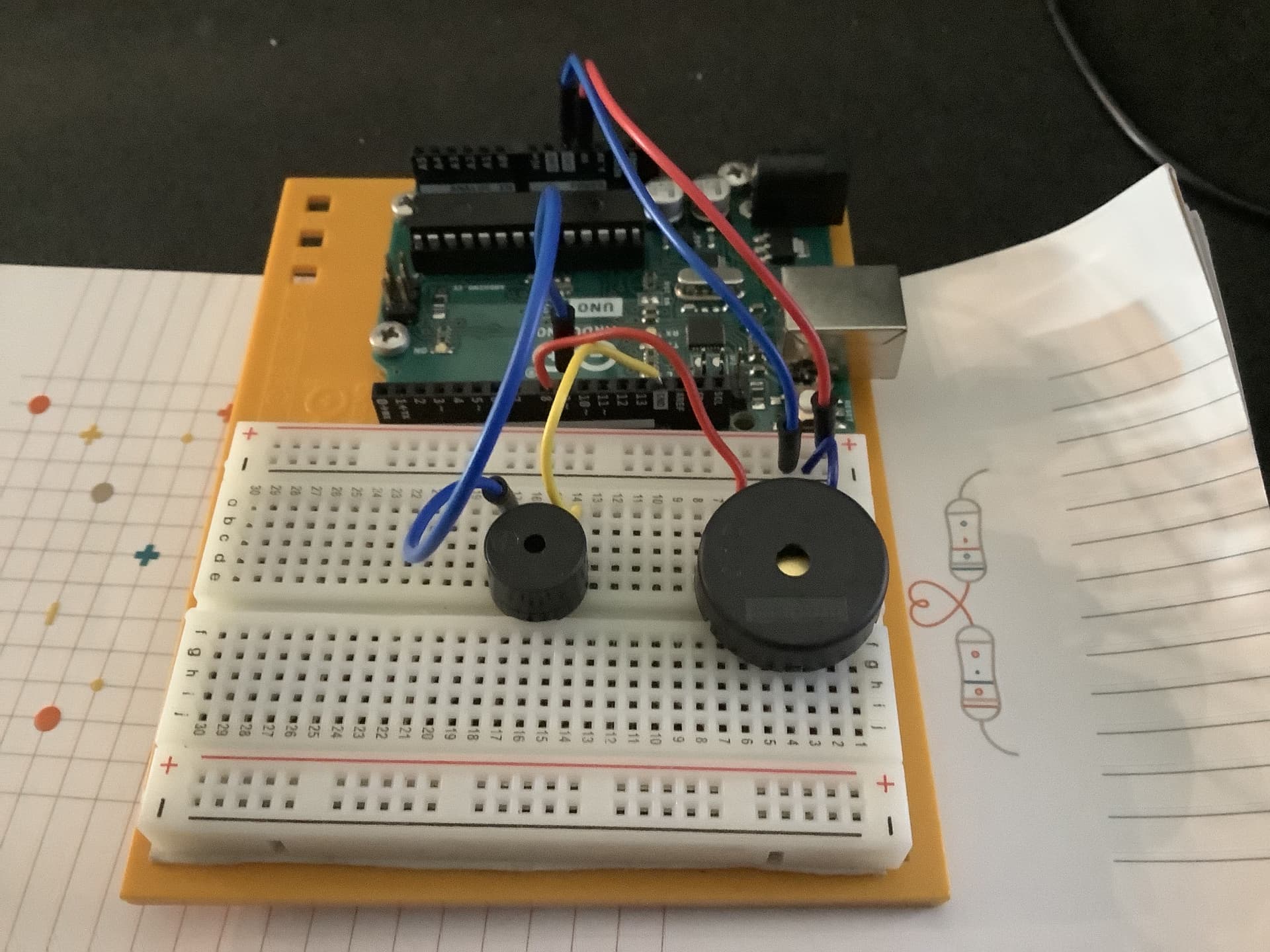

I'm working on a project where I'm trying to play the Imperial March theme on a piezo buzzer using Arduino, but it's not working out as planned. I thought I followed all the steps correctly, but when I run my project, I don't hear the music. I think there might be an issue with my code or maybe how I've set up everything on the breadboard.
I'd really appreciate it if someone could take a look at my code and wiring to see if you can spot any mistakes. Here's my code:

And here's how I've set up my breadboard (but I'm not sure if everything's connected right):
So, if anyone can give me advice on what I'm doing wrong or how to fix it, that would be awesome. Thanks a lot!

It looks like your code is correct, as it works in the simulator:

Check which rows the legs and pins are placed.
Also...
from...
Check what your buzzers do when you connect them directly to 5V, they should click and not buzz/beep.
Can you please post links to specs/data of your "buzzers"?
You may need a series resistor in the "buzzer" wire the limit current from the UNO.

It doesn't. It plays the melody until you comment out the melody, then it plays the harmony. And you wired up two passive buzzers anyway.
@3konverts - tone() only works with passive buzzers…
const int buzzerPinMelody = 8; // Active Buzzer for Melody
const int buzzerPinHarmony = 9; // Passive Buzzer for Harmony
HTH
