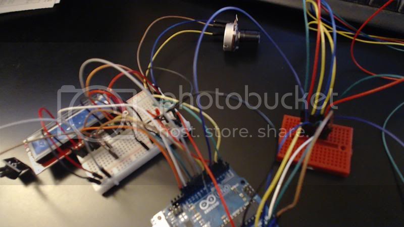

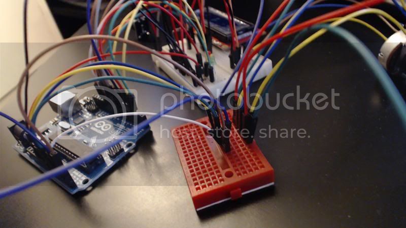

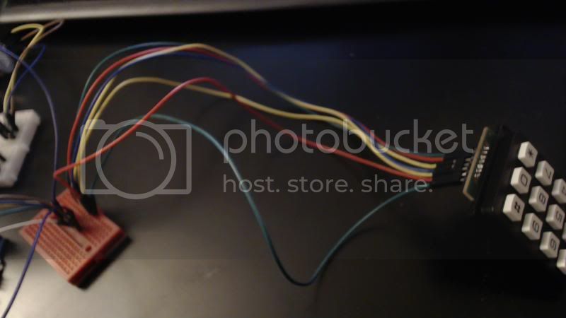

I am new to the world of Arduino and decided to attempt to duplicate a project off of Instructibles.com. I have the entire project connected properly (I believe) after reading the schematic. The only problem that I seem to be having is that my keypad is not registering the 2, 5, 8, 0, 4, 5, and 6. I attempted to do some research into this 4x3 keypad and noticed that pin out 1 and 7 are related to the keys that are not operational. I have pinout 1 connected to analog pin A0 and pinout 7 connected to analog pin A5. The following is the code that I am using:

I am utilizing a LCD with this particular project. I am receiving output on the LCD when I press the 1, 3, 7, 9, *, and # buttons, however when I press the 2, 5, 8, 0, 4, 5, and 6 buttons I am not receiving any output on the display. I am new to the Arduino and circuitry, so I imagine that this is a wiring issue
The particular library that I am utilizing is the one associated with the 4x3 keypad that I have wired up. Would it be an issue if I am using this library as opposed to the one that code designer added with the zip file? I tried to use the other one and numbers did not match the output as the shorts were not associated with the particular wiring I had set up. However, even utilizing this other library, I was still unable to get output for 6 keys.
No idea if this will help or not, but I ran into a similar issue with a membrane keypad:
http://forum.arduino.cc/index.php?topic=210925.msg1547944#msg1547944
Mine was displaying content from the previous column when pressing any button in the second column. It was a stupid issue, the male-male headers I was using were pressed in too far into the female headers that were attached to the ribbon cable of the keypad itself. Wiggling them and pulling them out a bit helped. The problem might be at the same point for you as well (I didn't see your keypad or the connections in the pictures, so might not be).
Good luck.
Which wires are going to the keypad? Have you tested the keypad using the digital pins, to make sure it works that way? If the digital pins don't work then it could be faulty wiring or just a bad keypad. Test with the serial monitor, no LCD and digital pins just to be sure.
Here's a picture illustrating what wires that I have going from the keypad to the breadboard then to the ports on the Arduino. I ordered a new keypad in case there was a hardware issue, however, it seems that a membrane keypad gave me the same results when tested.
