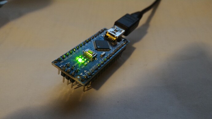

ATmega328P CH340G UNO "programmer is not responding"
Hi, I have searched these forums already looking for a solution to no avail.
Running Windows 8, arduino 1.6.8, with this board, ATmega328P CH340G UNO R3 Board from ebay.
Settings are
Board; Arduino Nano <oops, set to UNO actually..
Processor; AT mega328
Port: COM6
Programmer: AVRISP mkii < I have no idea which other to select?
Installed drivers from the china site posted in another thread here, CH341SER.ZIP (installed/rebooted)
Installed drivers from the arduino package, dpinst-amd64
I have not tried the FTDI drivers, not sure how to do so
Have tried 2 different usb cables, also different usb ports on my pc. I have the red and green LED's lit up on the board when connected, no flashing, just solid. I tried the reset button before hitting upload button.
I am not sure if this "unknown device" is the uno board (as seen in attached pic)
Nothing is connected to the board other then the usb cable.
The messages I get are in the attached pic.
Any suggestions to try are appreciated!

The screenshot clearly shows nano selected, and the expected error if you try to upload to an uno with nano selected...
What errors do you get with the correct board selected?
The unknown device I think is probably something else - does it go away if you unplug the arduino?

The unknown device in your device list is a "red herring" and your clone board is probably fine. Selecting the board type of Uno will not work with clone boards that use the ch340 usb<>serial converter. You should be selecting the board type Duemilanove.
The Uno and the Duemilanove use the same atMega328P processor but the Uno uses a custom USB to serial chip, the Duemilanove uses an FTDI chip for its serial to USB converter function. The CH340 is a Chinese copy (read cheap) of the FTDI. When you plug your board into the USB port, your computer identifies the hardware and it loads the appropriate driver. In your case, we know that is true since the device appears in your driver list as COM6. One the driver loads and a com port is assigned in the driver list, you're good to go. The Arduino software only knows about the serial device at COM6, it doesn't know the board type which is why you have to specify it separately in the drop down.
You also mentioned: Programmer: AVRISP mkii < I have no idea which other to select? the programmer selection does matter for normal downloading, the selection is only in effect when you are attempting to flash a new boot loader.

I had some of the same uncertainty with how to get the China-made atmega328P / CH340G board running (USB Nano V3.0 16M 5V Micro-Controller Board For Arduino | eBay). I wanted a cheap one to embed in a project, and $2.28 with shipping sounded almost too good to be true. I downloaded the driver for CH340G and was still having some problems getting a sketch to download properly, then I noted from this thread the recommendation to select the board type Duemilanove. This did the trick, now it is happily playing my go-to test sketch, "blink". Thanks!
