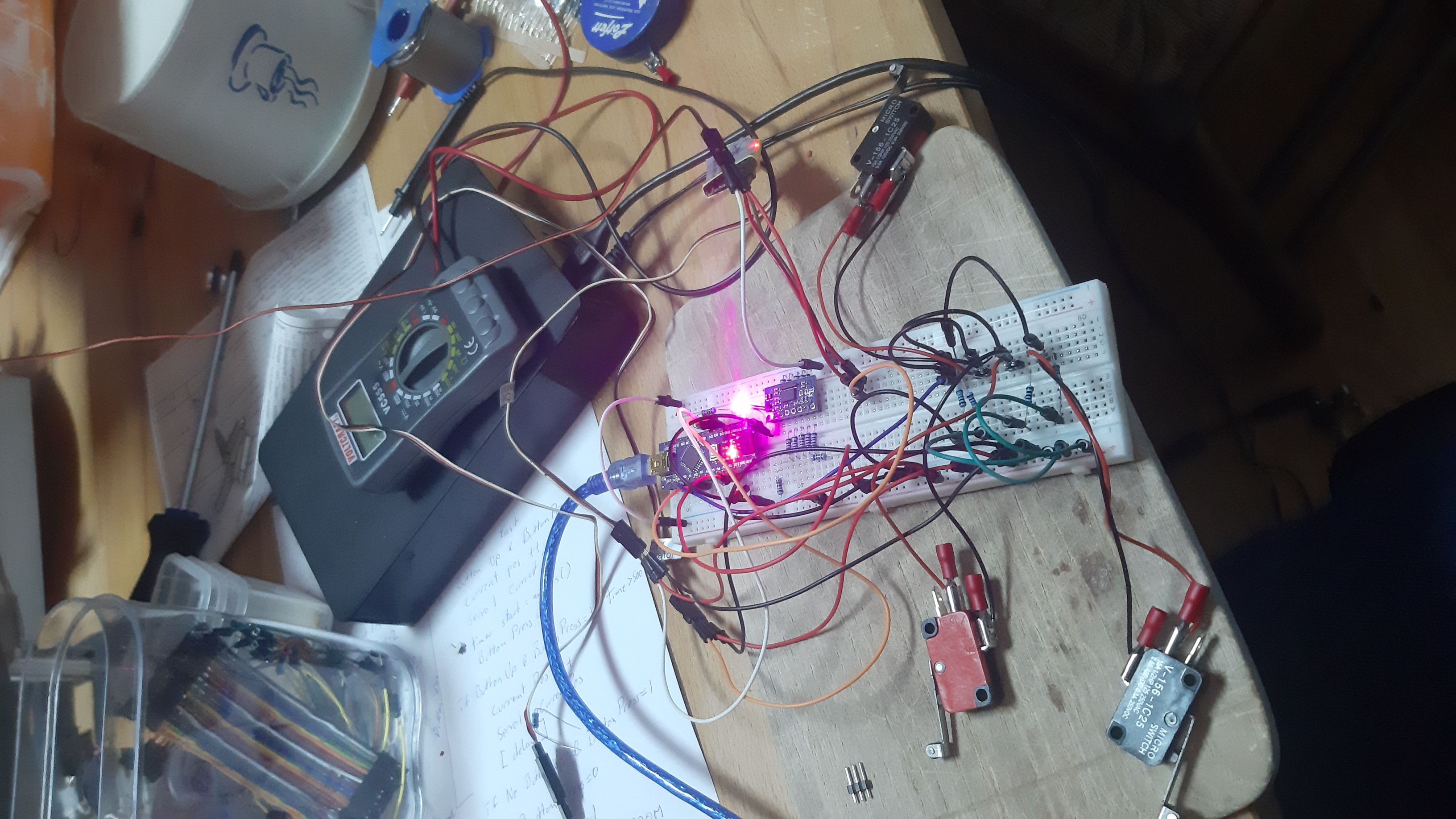

Hello community,
i'm back at the keyboard, andd for the first time moving away from my beloved nano to try out the attiny 85 board (with micro usb).
Project description: A sequencing unit to receive a servo signal (pwm range 700-2300ms) from an RC receiver, and control 2 servo signals according a predetermined sequence.
Servo 1 must be delayed while an electric motor is running. I will also need a "setup routine" to adjust servo 1 end positions.
Summary of inputs/outputs:
Input 1: PWM Servo signal from receiver
Input 2: Voltage input from electric motor
Input 3: Pushbutton "up" to change servo position during setup
Input 4: Pushbutton "down" to change servo position during setup
Input 5: Pushbutton "Enter" to confirm during setup
Output 6: PWM Servo 1 signal
Output 7: PWM Servo 1 signal
Sooo heres problem 1: i need 2 more signal than i can handle on the attiny (5 i/o pins). I was planning on handling this by splitting up the up, down and enter to different resistors on the same channel, to give 3 different voltages to 1 analogRead pin. According to the read voltage the position will be increased or decreased or confirmed.
I'm sure i will encounter other problems, but my main question is:
Can i use the attiny for this?
I want to use:
Blue 4: PWM Servo input (interrupt routine?)
Blue 3: Voltage read electric motor.
Blue 2: Voltage read of the up/down/enter buttons.
Blie 1 & 0: Servo outputs
Can i go with this setup? Where do you see problems? Restrictions?
Thanks for your thoughts

Pin 5 and 6 can do PWM using timer0 so that's good
I would use pin 7 for your servo input since that is where INT0 is
Other than that, everything looks okay.

If P5 is Reset, can i use it as an input/output? According to the diagram it should work. If so i have just gained 1 channel which i can use for a status LED.
So my plan is:
P0: Servo 1 Output
P1: Servo 2 Output
P2: PWM Servo signal from receiver
P3: Status LED
P4: Pushbuttons 1+2+3
P5: Motor voltage read
Any showstoppers here? Will start on the program structure now.
